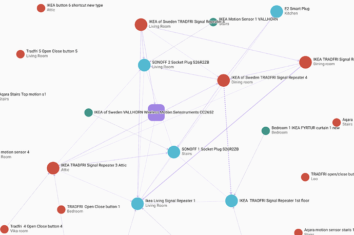

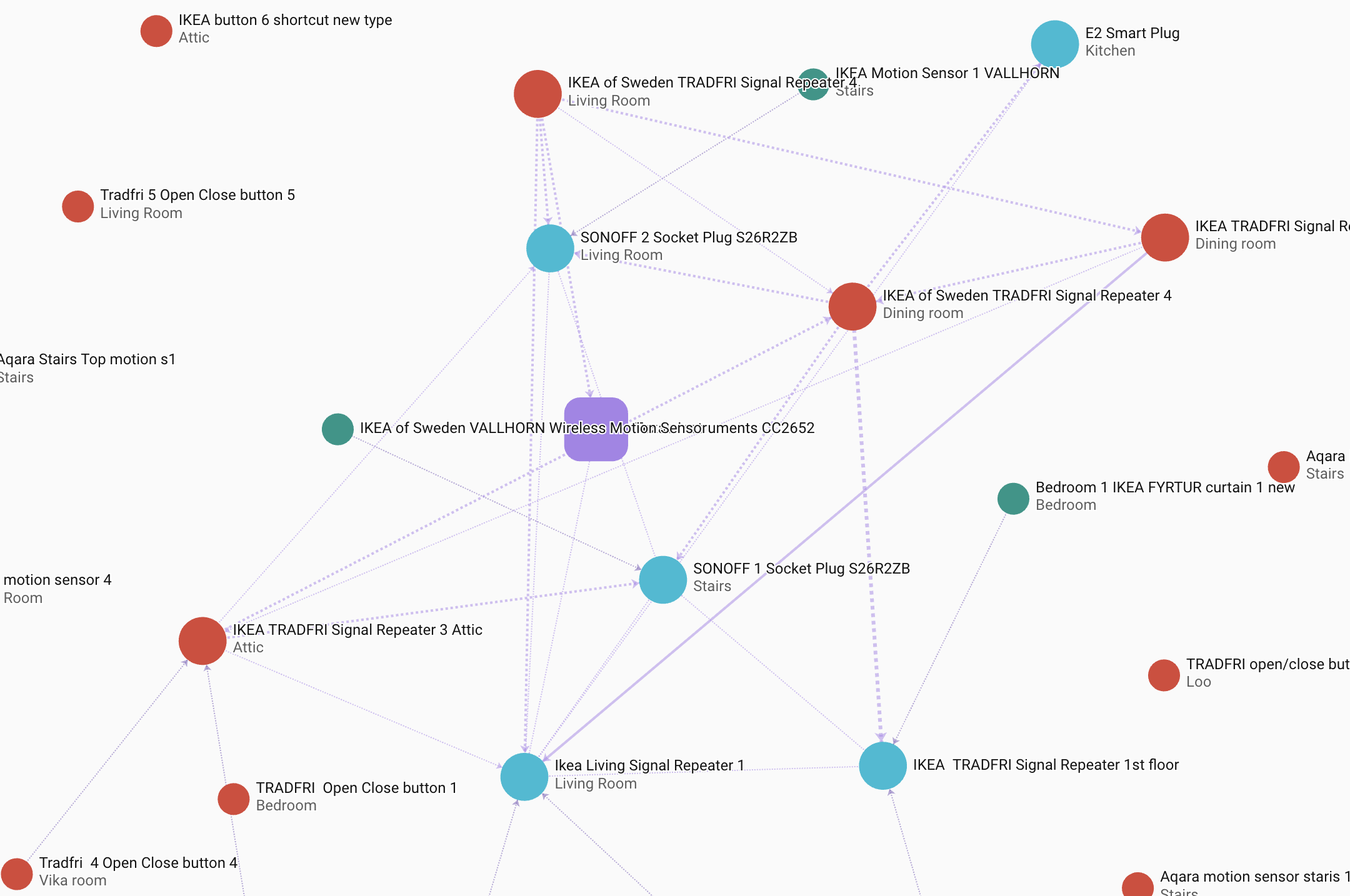

See only part of the network.

Some router devices are coming online, but end devices are still offline.
It makes me think I need to re-add all dozens of devices manually (, which I dread…

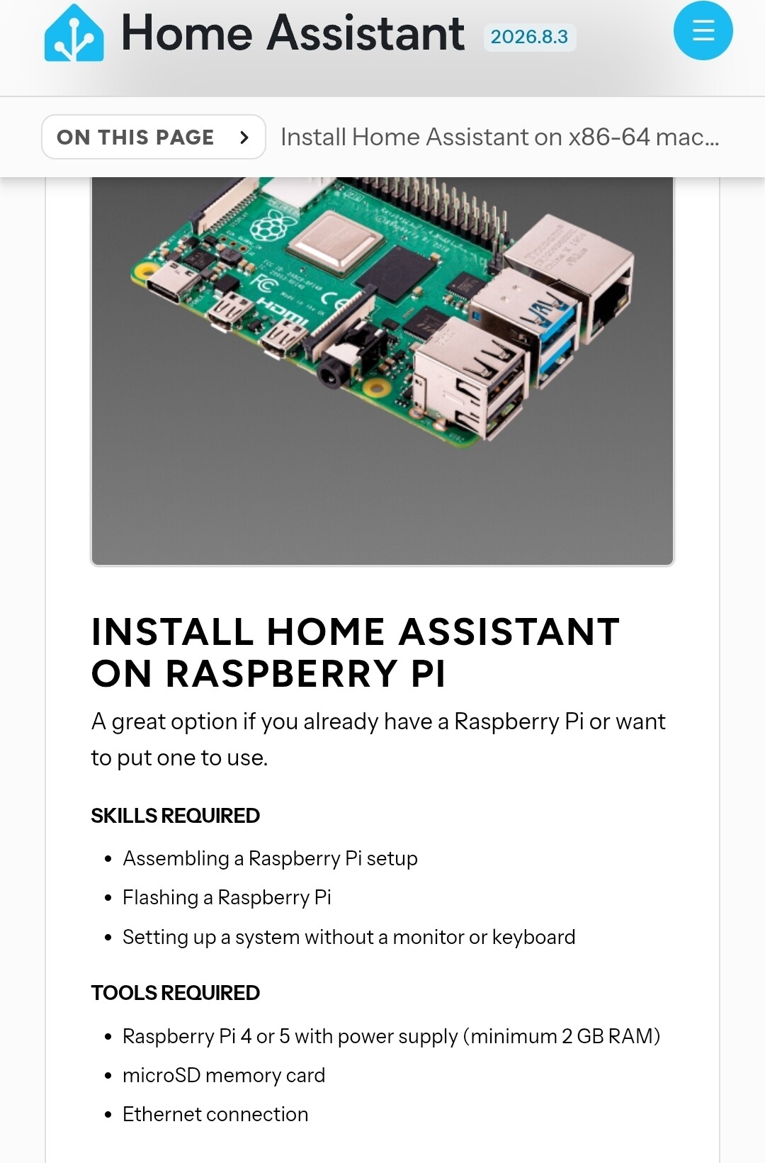

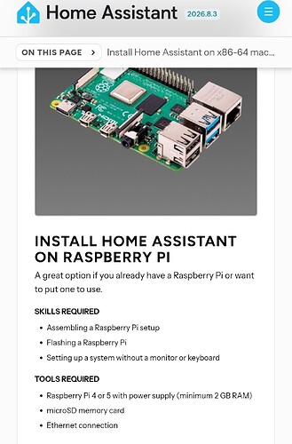

This is the HA installation page…
See the tools required under Pi installation… This is why that minimum ram number exists.
