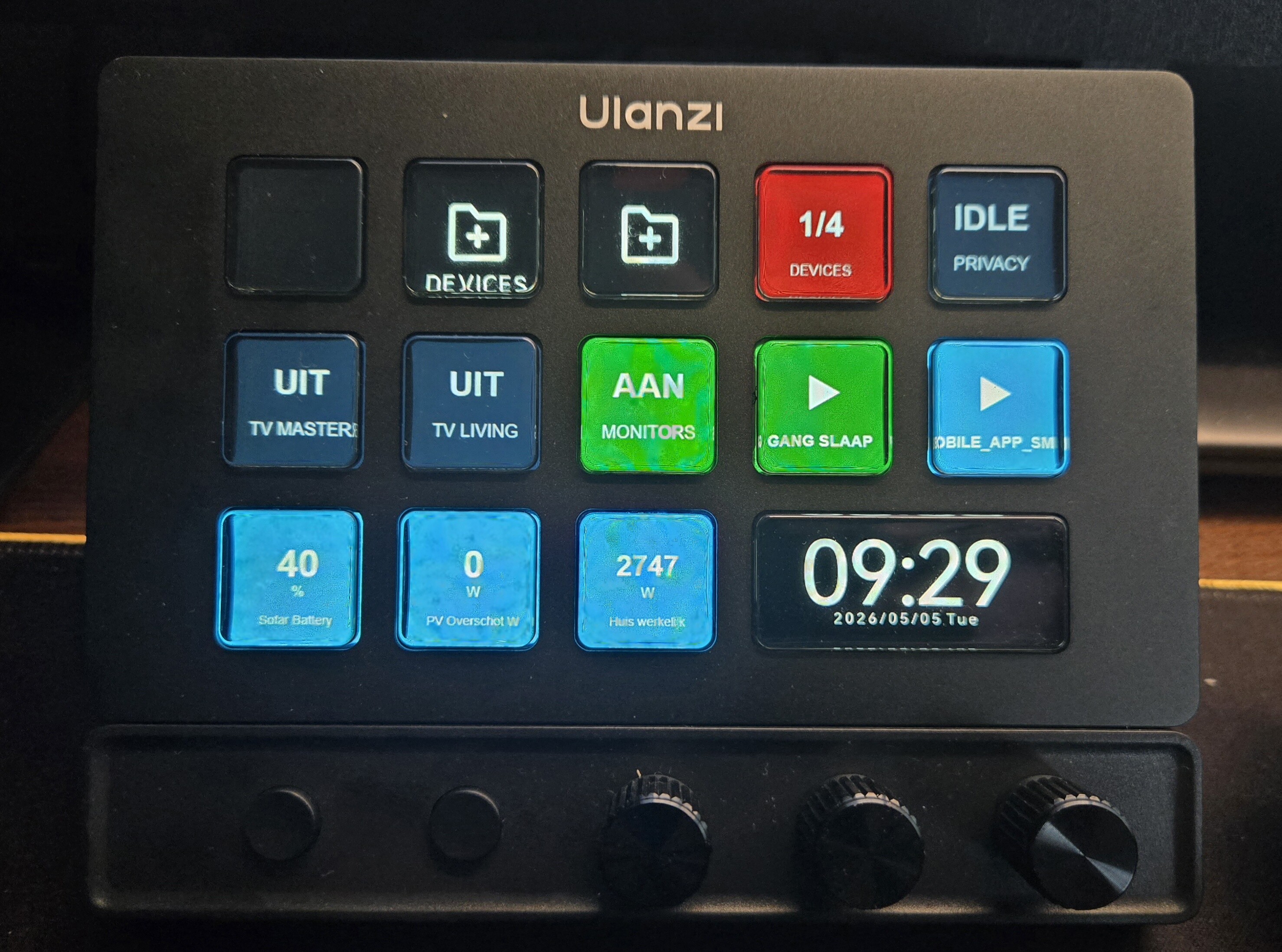

I’ve been building an open-source plugin for the **UlanziDeck D200X** (stream deck with 14 LCD keys + 3 rotary encoders) that integrates with Home Assistant. Sharing in case anyone here also has one of these decks and wants live HA control surface on it.

## What it looks like in practice
I have an Aggregate key on the home page watching four `binary_sensor.*` sensors for EV / washing machine / dishwasher / airco. When one of them turns on, the key pulses orange and shows “1/4”. A folder right next to it contains four Smart Toggle keys (one per device) showing live state plus tap-to-force-override.
For lighting: HA Toggle keys for office/desk lamps. Long-press any of them, the Smart Dialer encoder takes over and shows live brightness while I rotate. Press the dial to turn the light fully off. Tap the source key to confirm.
