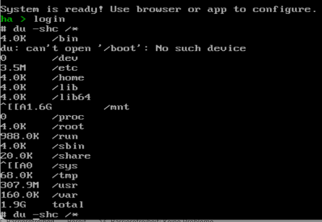

Check what uses all the space like this. Also share this.
I did not really get a good access to the data. I could only do a screenshot and the biggest chunk is in mnt but there seem to be no subdirectories.

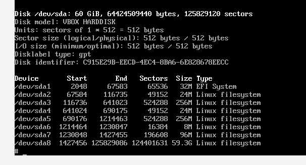

Can you provide the information requested in the second link?
And execute the following command on cli?
fdisk -l
It will show the disks known to the system + their size

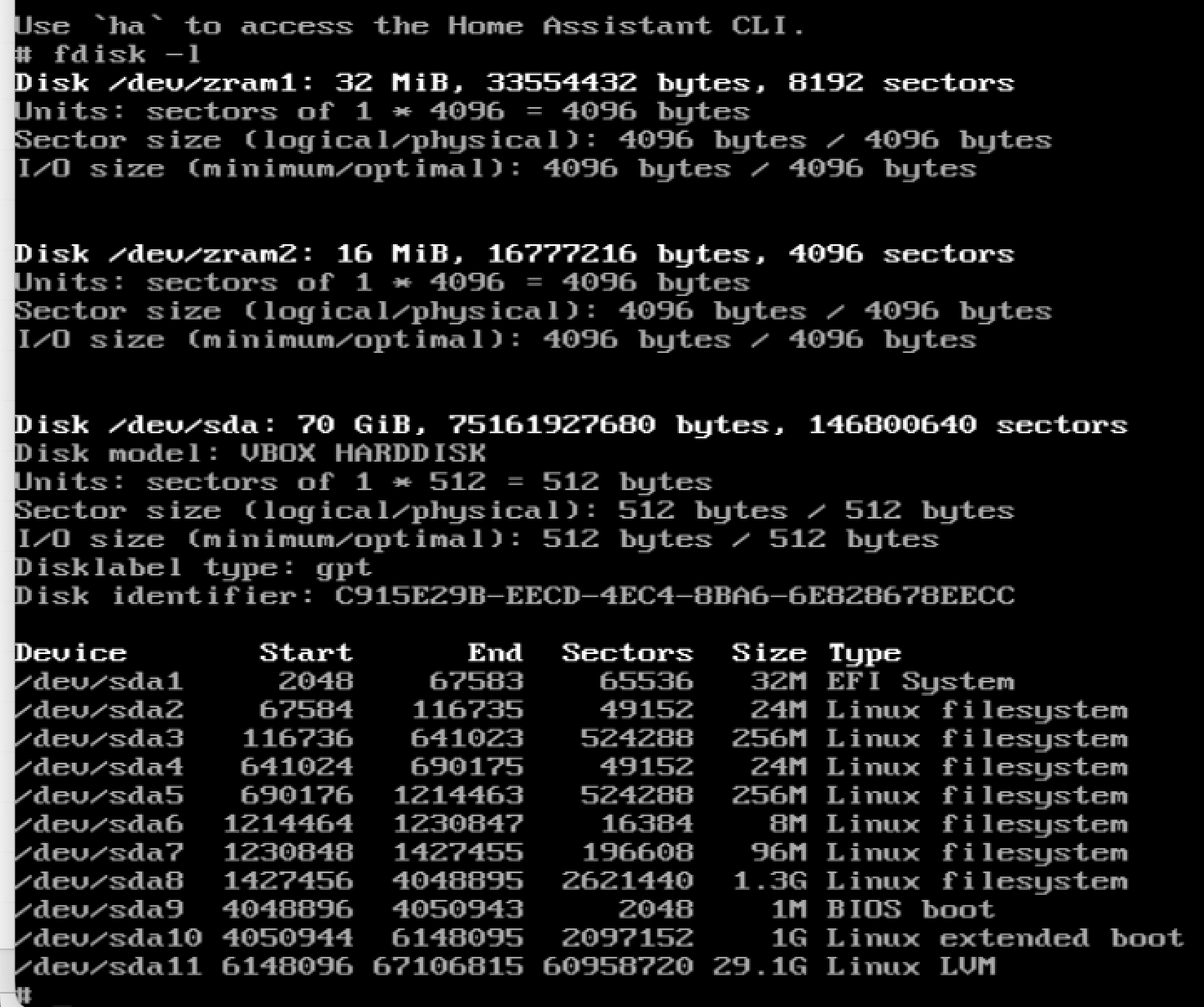

Sorry for letting you wait. The ‘_my_redirect/storage’ was not found and I cannot add the ‘_my’ extension.

AFAICT the virtual HD image didn’t expand during setup, you’re using only a part of your 70 GB (see fdisk -l output)
just tested on my VB
you have to resize the vdi before booting for the firtst time
HTH
