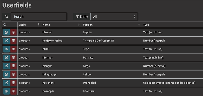

d. I’ve created some userfield to register some specific details of cigars

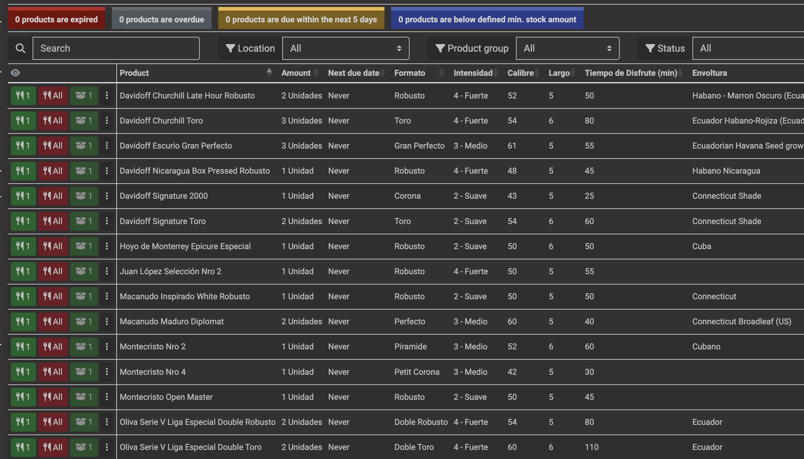

e. Then you need to start creating each product, one per cigar type you have. I take the time to find one picture of each one from manufacturer or reseller sites, and also add some wording detailing flavour, pairing etc (on “Description” field.
f. Then from “Purchase” menu you can start adding your stock, for each cigar product created you can register how many you have, the price you bought it, which humidor is stored and where you bought it.
g. With this you get your full stock in Grocy. That is indeed a very good tool to do all the job.

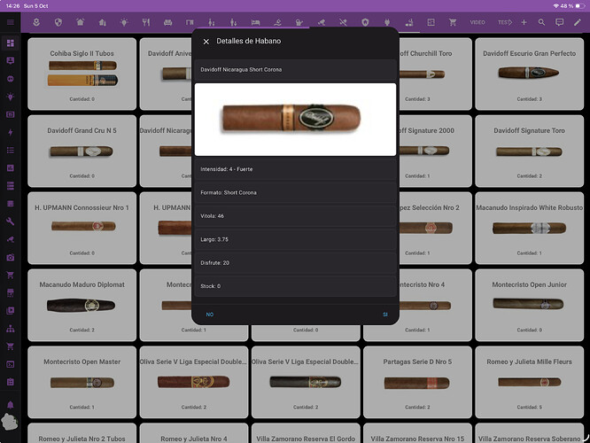

I’ve created a lovelace page that present you overall status of electric humidor content. (The picture in previous posts)

The code below create a grid with a small card for each product created in Grocy, include “Product Name”, “Picture” and “Stock”.
When you double click on any card a browser mode pop-up give few more details on the cigar selected.
