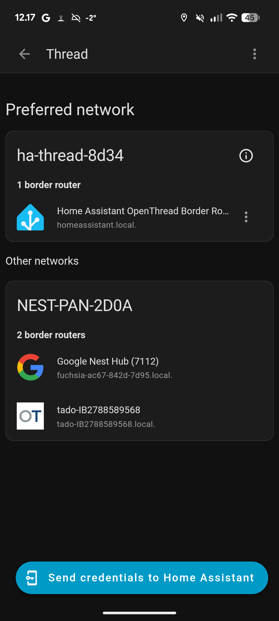

Here’s the Matter network overview, I’ve set the HA Yellow as the preferred network:

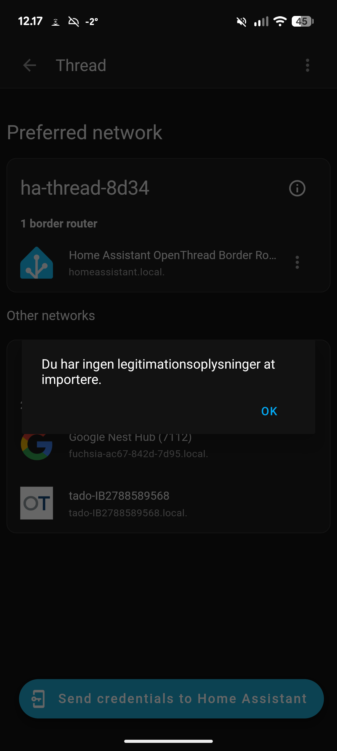

When I try to Send Credentials it says the following:
(“there’s nothing to import”)

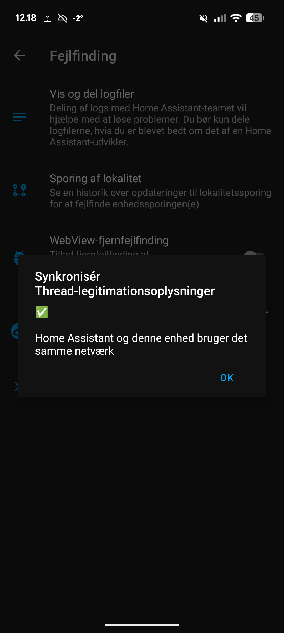

And then I check the Companion App settings and get an all clear:

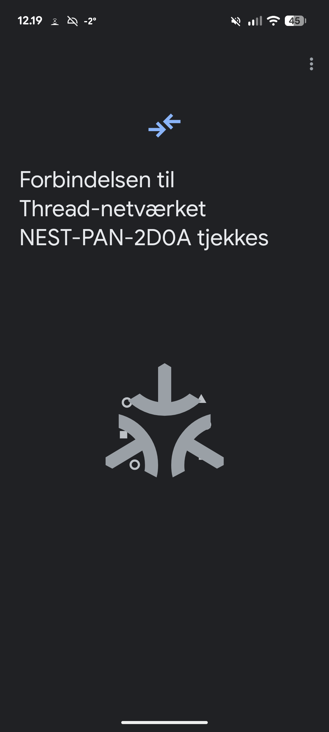

But when I try to adopt a IKEA Matter bulb it finds the bulb and starts the process, but at this point it seems like it “jumps ship” to another network:
And then afterwards the entire process gives an error message.
