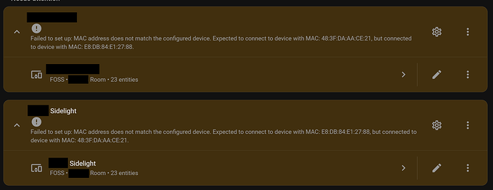

HA keeps confusing 2 WLED MACs
I have no idea why but these two WLED instances keep failing in HA and they seem to swap MAC address’ or something is happening in HA to get them confused.
I have around 5 different WLED installs and all the others work fine, just these two seem to keep swapping MACs.

As far as I know I haven’t done anything, I just started to notice the problem because one of the lights started to not work with an automation.
They were set with a static IP when it first happened, so I have changed them to dynamic and the same issue happens.
The blanked bits are peoples names for a given room so hidden for privacy reasons.
I’ll check what is happening with the router and assign them static IP address’ from there and see if it fixes anything.
These were both added to HA via the WLED auto discovery.
