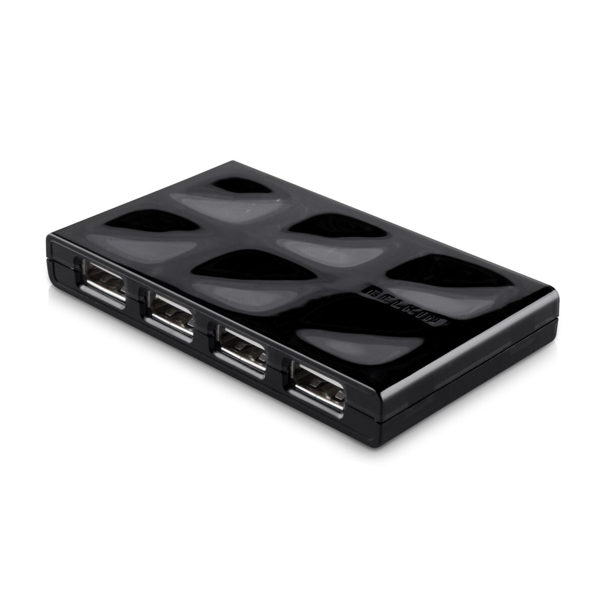

With my RPI setups with lots of USB devices.
I use a cheap BELKIN ACTIVE USB HUB.
Try to add one.
