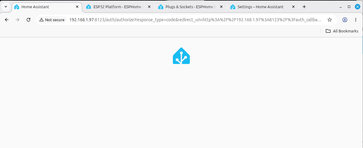

I have just updated to 2026.5.2 (Supervisor was already up to date) and after HA rebooted, it wouldn't reach my home dasboard: I had the never ending loading spinner.
I had to physically switch off/on my RaspberryPi to regain access.

And did i mention that http:192.168.1.97:8123 no longer works, but http://homeassistant.local:8123/config/dashboard does ?
