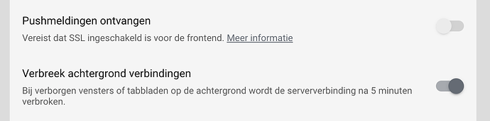

Somehow this only happens ā€˜returning’ to the browser after some time.
which made me feel it has to do with this Profile setting
but that would be odd, as I have had it like that for longer time, and, I can see what it does when it wont connect and I can simply reload the view.
not when it lost hassio.local however, in which case no reload is possible
