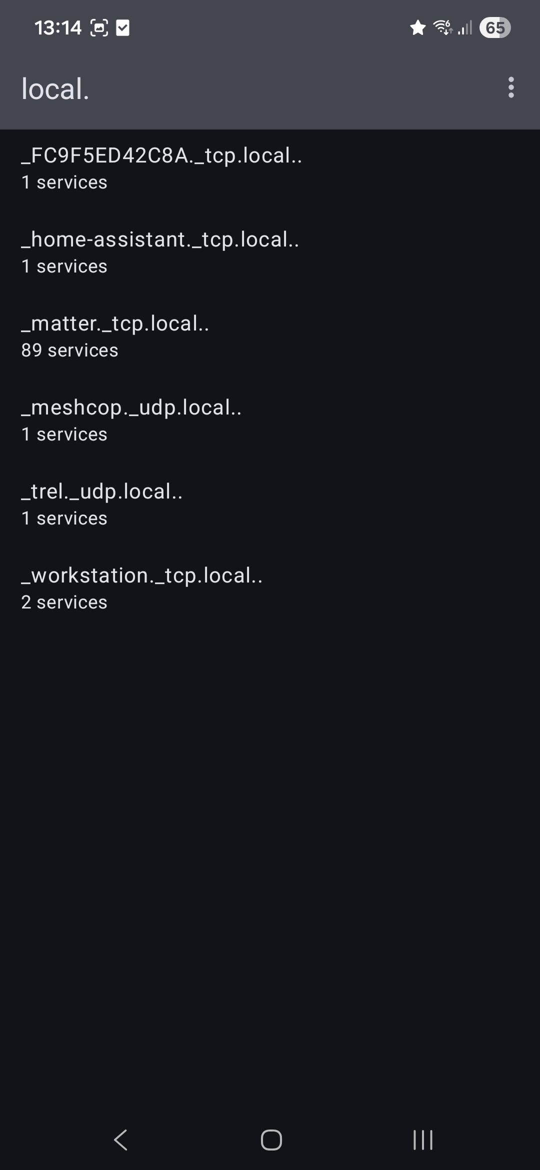

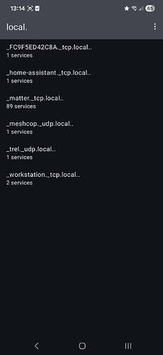

I downloaded a Bonjour/mDNS service browser on my phone, it couldn’t see my Thread Border Router at first, but after I did the restart of Home Assistant VM it popped up in the app - see attached image of the service browser app. The app can see Home Assistant, Thread Border Router, my phone and some other devices available via mDNS discovery.
At one point the Thread network was visible during all this troubleshooting, but then disappeared under “Settings → Google → All services → Thread-networks”, from not visible to visible shortly and then not visible again.
