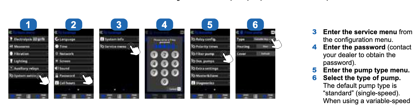

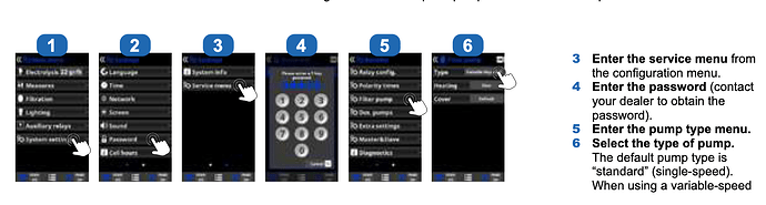

I know itās off topic, but does anyone here owning an aquarite + know the 5 digits code to access the service menu? This menu is mandatory to configure a variable-speed pump but even my reseller canāt get it and I tried to call the vendor with no successā¦

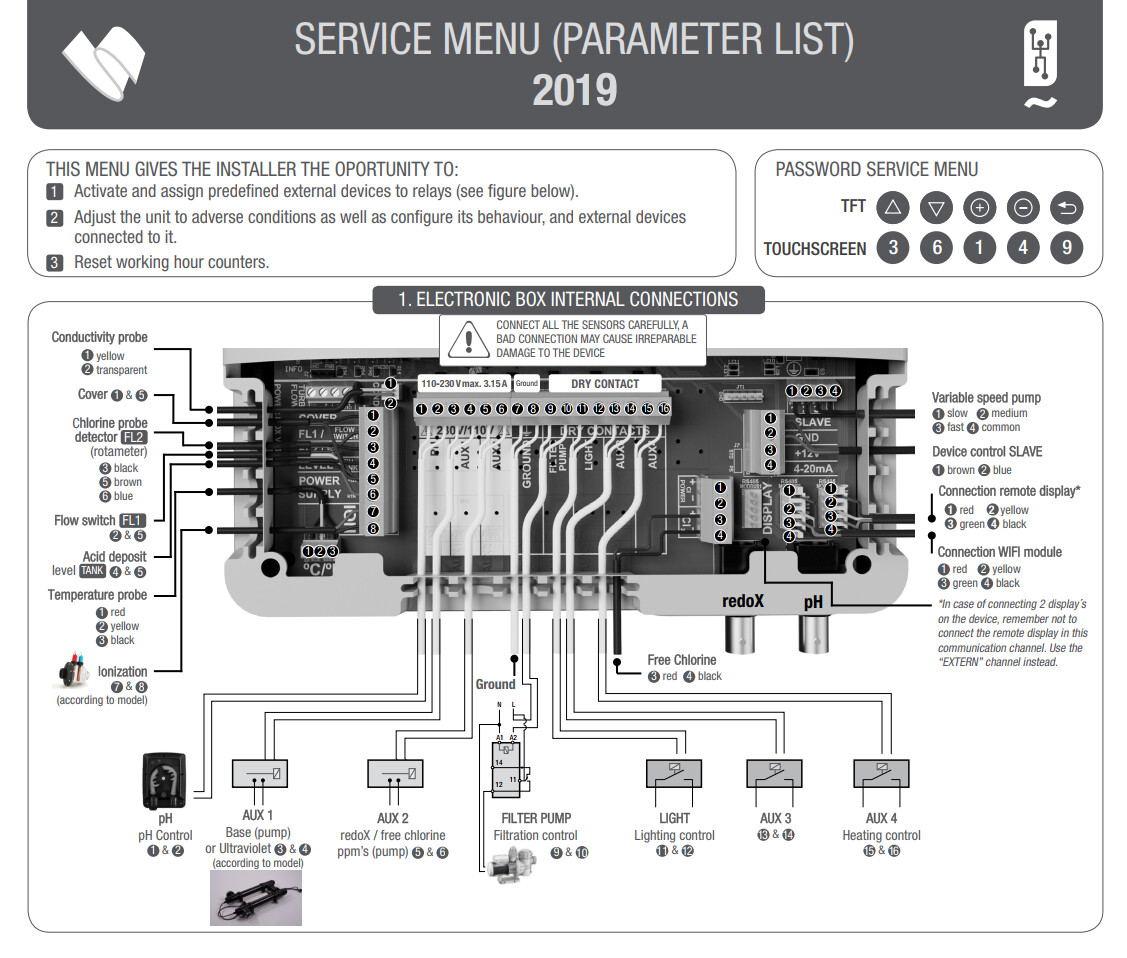

Here you go. You can download the service pdf here.
Many thanks ! Why the hell did they remove it from all documentations? No one seems to be aware of that, even the vendorā¦
They are aware, and they donāt easily spread the info because they want to keep it inside their support channel (partners, etc.).

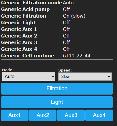

Hi, Here there is a similar problem:
I have got Hayward Neopool + NG, Iāve already install Atom Lite + Tail485 with tasmota, Iāve also installed berry commands:
Filtration, light, mode are tested and it works perfectly but when i try with AUX outputs only it works Aux1, the other ones I try to activate it by tasmota console but it doesnāt work( in tasmota neither in physical output ), Iāve reviewed so many posts but I donāt know if there are something more to implement with aquarite or I miss something.
