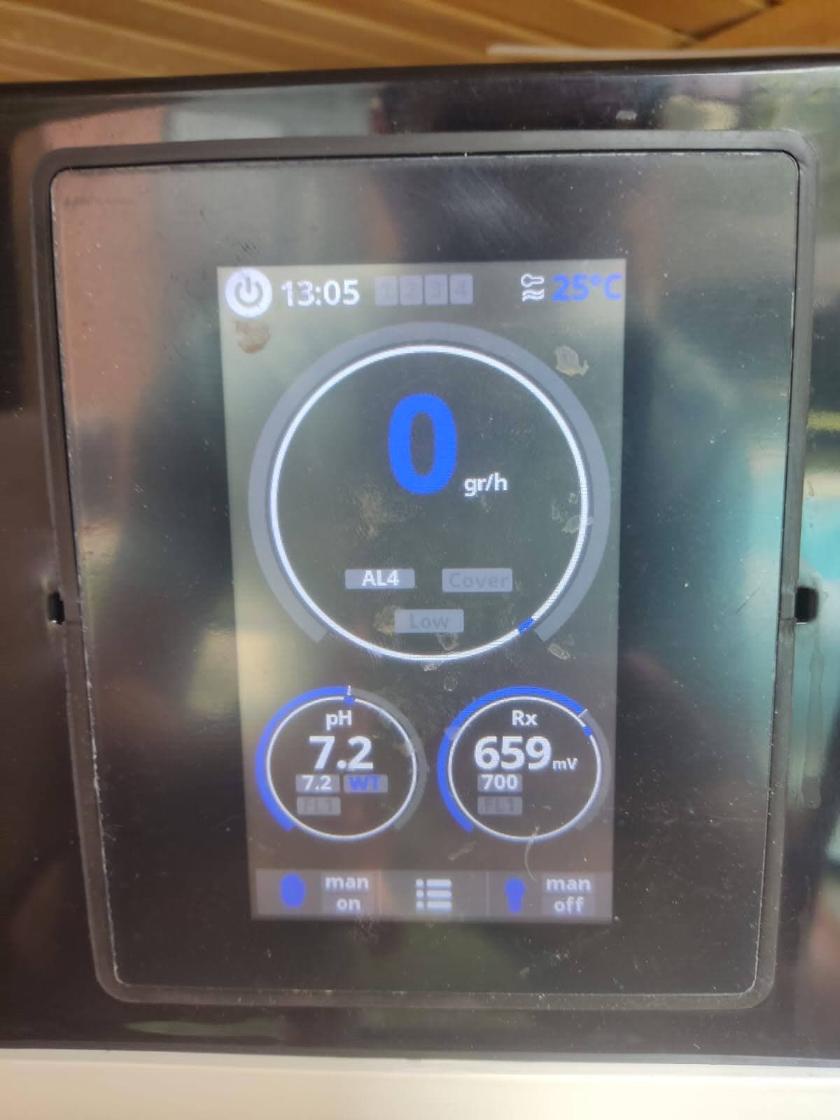

hello to all fellow Neopoolers, sorry for being slightly OT , but i’m trying to fix an issue i’m having at chlorine production, and Hayward support is not much reactive, apparently when i go above 28c the system is producing less chlorine for this reason i took one size up , to fit my 38m3 pool i’m running ox1.
The cell is the The cell RCB16 should be rated 15A therefore a total power of 25v X 15a = 375w.
However when i’m running the cell 100% and i put a CT (amperometer) i’m able to read the difference in power from 0 to 100 % of just 60w.
i run the cell overnight (no UV from sun ) and the calculated production in 10h has been approx 6g/h at 100% with temp approx 28-29 in that period.
So this is rated 16g/h is a reduction of nearly 70% of the production reasonable or not ?
The cell is just being clean, 2500 h approx of lifetime and i’m challenging the support to address if there is a fault on the HW.

I Again:
I’m really scared right now:
After the last post, when I launched what you indicated, I went to hayward touchpad and I saw AL4:
so I couldn’t start chlorine, I saw it was related to external control, I looked for it in service menu and it was indicated as number 1( depending to redox ), I changed to 0 and after to 1. But AL4 remind there.
:scream:
Not sure if it is related or not but What Can I do?
This has nothing to do with these tests.
AL4 is an alarm message (I can’t remember the reason right now, but it’s in your manual); alarm messages must always be confirmed manually, after which the system will return to normal operation.
To reset an ALx message, press the circle that triggered the alarm for 3 seconds.
Alternatively you can send Tasmota cmnd NPEscape or hit the NeoPool "Clear Errors " button within this HA integration
*Edit: Description of reset options completed
