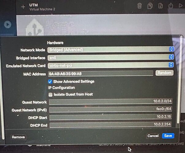

Bridged network is the one you should use, but if promiscuous mode is not enabled on the network interface on the host, then the network driver or chip will drop all packets for the hypervisor, since it uses another MAC address than the network interface itself.
I am somewhat of a newbie to deep networking issues. By host, do you mean my UTM or the MacOS that hosts the UTM? What is promiscuous mode and how do you enable it in bridged mode?

I installed UTM… Now is your network settings looking like this?:
Or do you have different settings?
It works just like your internet connection.
On the local side you have a bunch of IPs, but on the public side you only have one.
Yes, your Mac will have one IP linked to its MAC address and your virtual machines will have one IP address linked to their MAC addresses.
I tried those settings, but the connection from remote machines on my network absolutely failed. Here’s the screenshot of settings that finally worked, which I arrived at by stubbornly patient trial and error. And I have no idea what en6 represents.
![IMG_0892.jpg](blob:https://community.home-assistant.io/6d8839b5-0aac-43a2-aba0-e53846aed632
Glad you got it to work.
en6 is the name of the network interface as it is named in mac os.
You can find all the names by typing: ifconfig in a terminal:
