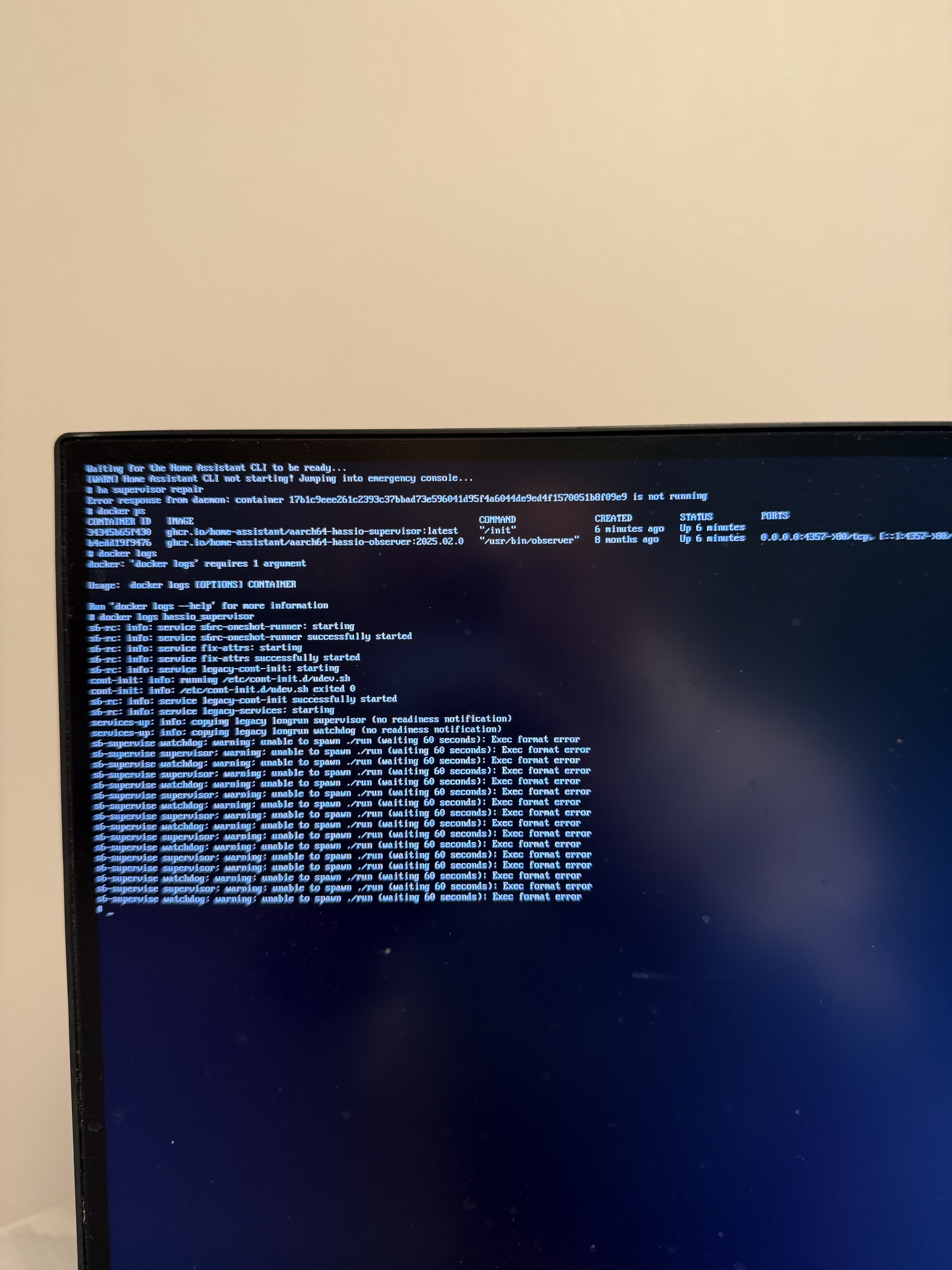

Tried connecting a screen and keyboard.
The IP matches what I see in the new router. But I still cannot connect. Unsure about those errors that are printed after the ha> prompt…
Looks more then a router change. Did you power off your HA by plugging the electricity out?
Yes I did.
Things get even weirder. Got thrown into emergency console.
login just loops back to emergency console.
Tried repair, but said container not running.
Looking at the container logs, that error looks like an image was pulled for the wrong cpu arch? :thinking:

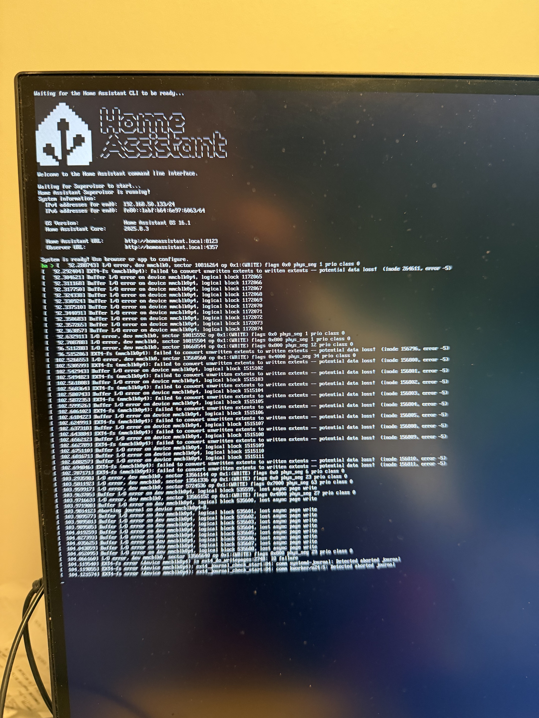

Soo, I managed to get in again by manually deleting the latest docker image for supervisor from the emergency console, and then restarting. The weird thing is that I updated my HA from the web ui, which I’ve done a million times before. I probably did this around the same time as I was changing my routers. So probably not related to the router change at all, but rather the fact that HA for some reason decided to pull a new image. More digging before updating again I guess.
This I what I see now
…and this
Yeah, probably this. Looks very shaky
