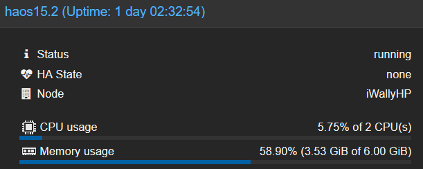

  1. HA is running on Proxmox: I know it is not recommend and supported, but this allows me to separate phisical resources between HA, Frigate (which runs separatelly) and Jellyfin. The underlying server is connected to the router with a cable, external access happens via Cloudflare and I had not network issue.
  2. In normal conditions HD has plenty of space (50% free space)
HA uses less than 7% of 2 CPUs and more or less 3 out 6Gb of RAM

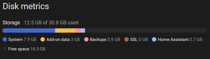

  3. After VM reboot HA seems to be running out of space: disk metrics is almost full with “Home Assistant” (light blue bar) using all of the available space.

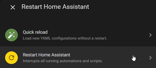

  4. In a rush to restore normal condition I have rebooted HA and it came back to normal disk space free condition.

For the sake of completeness, the VM is compliant to the minimum HW requisites. I did not assign more HDD space because in normal conditions I have more than 18Gb free.

Restart rotates the logs, log.1 is the file from pre-restart.
Yes, homeassistant.log.1 will be deleted.
Homeassistant.log will be renamed to honeassistant.log.1.
A new empty home assistant.log will be created.

If you have about 15gb of HA stuff and files, the backup is generated on the tmp folder in that same drive and could well be that same size (or bigger). Then if memory demand is suddenly high, the swap file grows as well eating more space.
I would recommend twice as much free space as space used for safe operation, so if you have used 1/3 of the drive space, add drive space.
