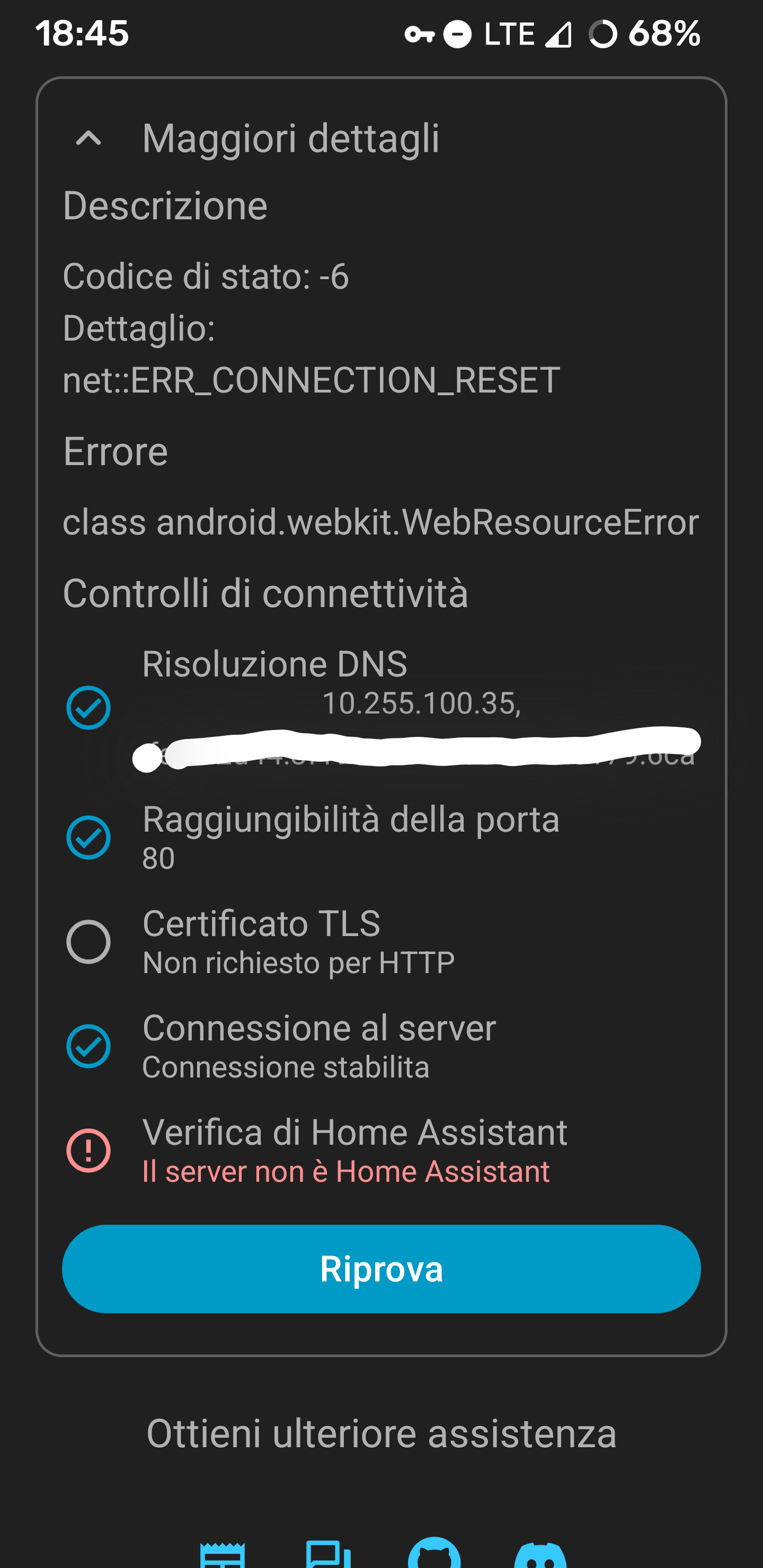

I tried different ways, even downgrading companion app, but the best result I got was to see a “not home assistant server” from companion’s log.
The addon declares everything is fine.
Orbot log says that connection doesn’t occur likely because the need for a key, but this happens both with and without keys (stealth mode) enabled.
I attached the picture of what companion says.

If this is only happening on your mobile when using the companion app, then it might be caused by the new(ish) Connection Security Level settings introduced in companion app version 2025.11.
EDIT: Your screenshot shows it’s attempting to connect on port 80 (http). I believe it should be connecting to port 8123 - that’s why you’re getting the “Il server non e’ Home Assistant” error.

Managed to find another issue where the screenshot shows port as 8123.
Check the Internal url in the Companion App Server settings - it should end in :8123. Also, make sure you set it to recognise your Wifi network, otherwise it won’t be able to determine if it should use the internal or external url.
If that still doesn’t work, try to set the security level to less secure as a quick test. If you manage to connect that way, then your issue is with the security level requiring you to turn on the VPN option due to Tor/Orbot.

I managed to request port 8123 (it was enough to put :8123 at the end of .onioin address).
