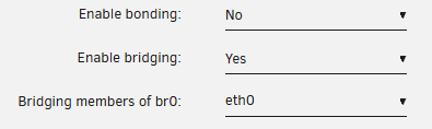

/24 means that the first 3 octets define your subnet. Since the first 3 octets of those 2 addresses are not the same, it means they are not in the “same” network. This indicates that your Unraid network interface probably did not have bridging enabled when you ran the setup container.
Enabling bridging on a network interface will allow Docker and VMs to access that physical interface directly. If bridging is not enabled, then the VM will make up a random network on a “virtual bridge” (virbr0) that won’t have direct access to your home network. Unraid will try to setup NAT internally to pass traffic around, but I have personally not found that to ever work out of the box for me.
If this is the case for you, here’s how to fix it…
First, you have to turn off Docker & VM services in Unraid (via settings page). Once these are disabled, you will be able to edit your network interfaces (also via settings page).
Find your active network interface (probably eth0, but it should be the one that is actually wired to your network) and make sure “Enable bridging” is set to “Yes”. Another dropdown will appear called “Bridging members of br0”. By default, the interface you are editing will be selected. That should be enough.
Save the interface changes.
Enable Docker service.
Go back to VM Manager and look for the “Default network source” setting, it should now say “br0”. If it doesn’t, you should be able to select “br0” from the dropdown.
Reenable VMs and save your settings.
Go back to VMs page. With the HA VM stopped, click the VM Icon then Edit.
Scroll down to “Network Source” and select “br0” from the dropdown. Then save settings and start your VM.
**Alternatively, since you have SpaceInvader’s container, you could also just recreate the VM. Click on the VM icon and select “Remove VM” (not the option that removes the disks). Go back to Docker and restart the HA Container. The container will reinstall your VM using the existing disks (should only take a minute or so).
You can watch the logs or just wait and refresh the VM page but once it is up and running, the “IP ADDRESS” column should show 3 addresses. The top address should now be in the same subnet as your home network (ie: 192.168.50.x).
