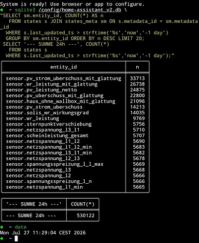

I use a RPi 4 with 4gb RAM and HAOS. Wrote some pysctipts to get all sort of electricity data from grid, PV and so on, polling every 15s. This and a few calculated template sensors are by far the biggest contributor to my database writes.
My initial (new) sd card died after 10 weeks from bad sectors. My recommendation: Go for a SSD with DRAM. I found a Samsung EVO 960 Pro in an old PC of mine - and it’s not about speed but reliability. The SSD controller uses internal DRAM to collect all those small i/o and then writes to the disc in bigger chunks. Plus SSD controllers have great algorithms regarding wear levelling. More expensive SD cards have some basic wear levelling, though.
As a small backup…

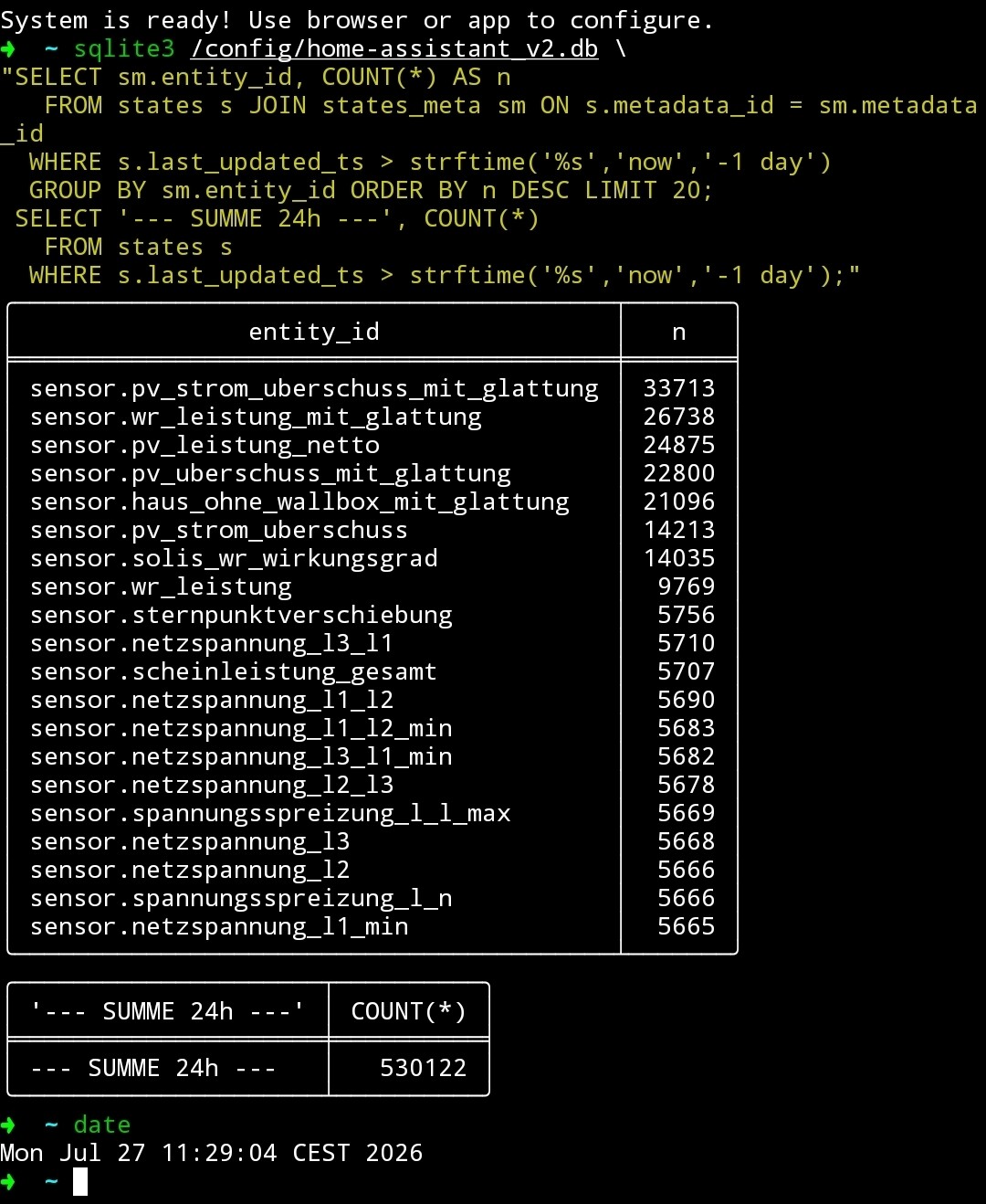

As you can see from that picture, for me there are 530k state changes per day. And I already excluded all raw sensors (from pyscript) and others from the recorder.
Generally I am happy with my RPi setup. With all my scripts, integrations like AdGuard Home, ocpp, Shelly and more: 1.3GB RAM used, 5-10% CPU. Very stable…
