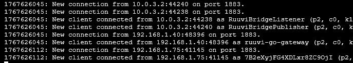

But when I try to connect from the ha to the broker the connection fails every time. On the mqtt broker I see the connection happening though. No fails no errors. But on the ha I always get this:
I dont believe its an authentication thing, because setting the broker “open” doesnt help. I dont also believe its a problem with the broker because the two ruuvi-software I have running are connecting just fine (at least to my knowledge).

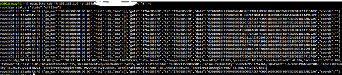

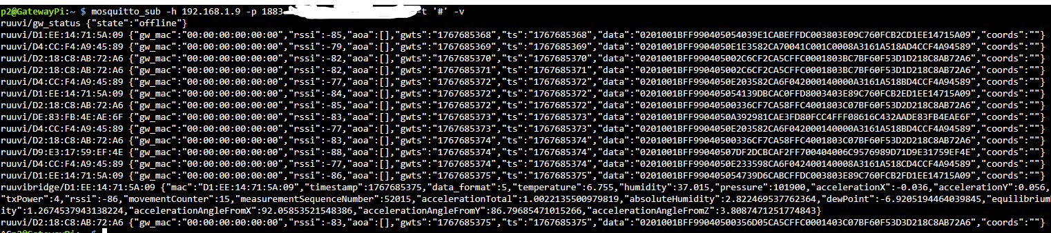

This is from my pi, checkin the connection to the mqtt server.
Thats why I was thinking its not a network problem if I can connet the mqtt server outside of the qnap itself.
