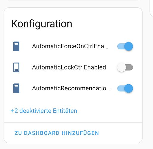

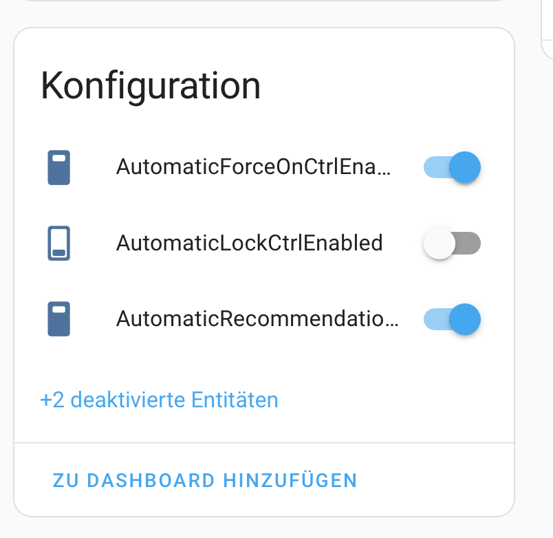

Recently I have added the Fenecon Relaisboard and installed the App “power to heat” to utilize an electric heater for hot water. Is there any chance I can control that from HA? I couldn’t find any entity for that. Do I need to reconfigure the integration? I don’t want to lose the historical data.
Thanks, Thorsten
I used this app for controlling a heat pump and there are some switches to control this app.
No clue, how this looks for a heating rod though.
This scenario is supported by the integration. It is also described in a separate chapter of the documentation:
https://github.com/Lamarqe/ha_openems?tab=readme-ov-file#check-the-backend-for-configuration-changes-change-connection-details
However, I noticed a few problems in the corresponding code, which I fixed with v1.0.2.
So please update first and try afterwards. Please let me know if works as expected.
Which entities are the ones that the can be controlled via the regular FEMS UI, I cannot tell you (due to missing dev&test setup). You will have to try yourself. Its also possible that some configuration options of the integration need to be extended (eg for the dropdown options). I would be happy to work with you here to extend the respective config.
