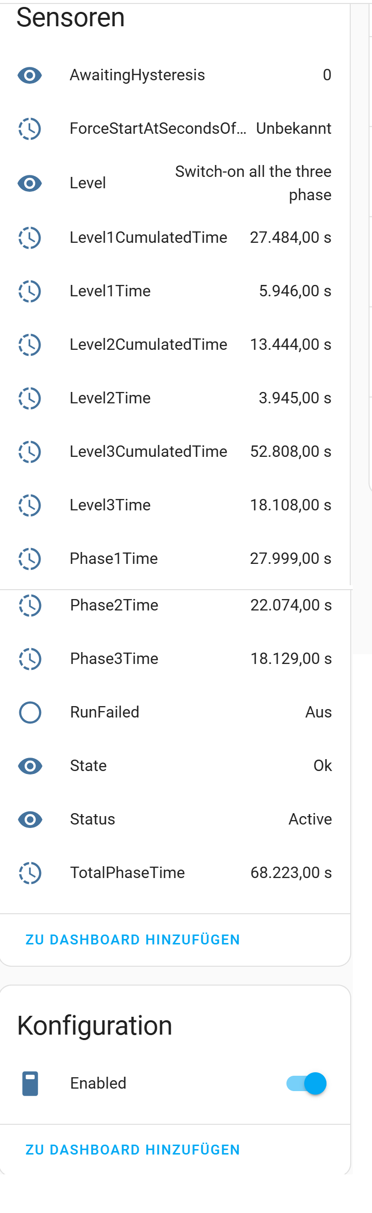

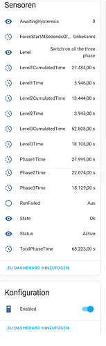

Thanks for the quick reply @Scritch & @romal! I did what you suggested, updated to the latest release and updated the config entries as suggested in the documentation. I saw a new device “ctrlIoHeatingElement0”. After activating the 2 entities, 15 more showed up (16 sensors & 1 switch):

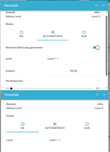

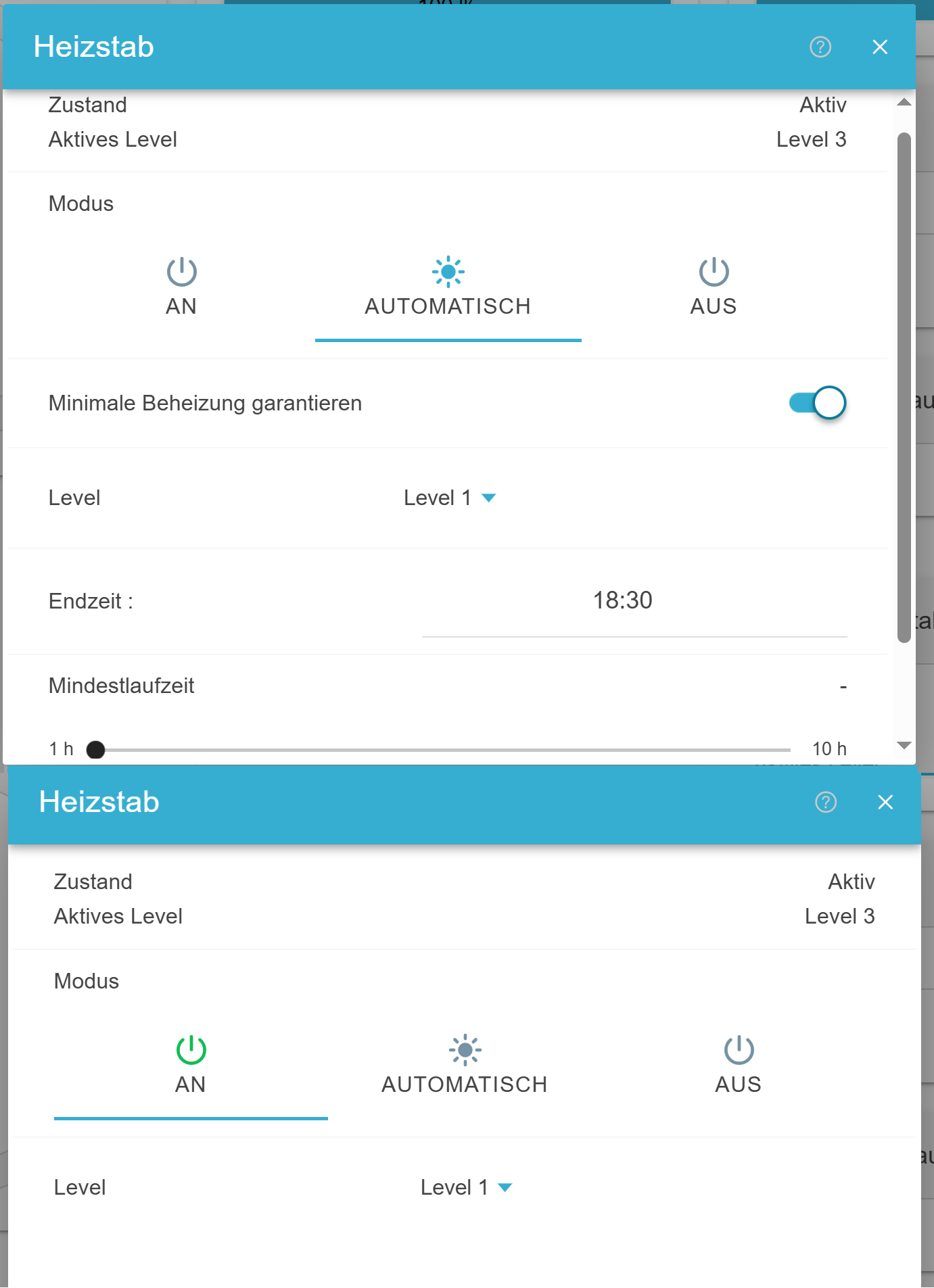

So far so good! Now, what I’m actually trying to do is manually activating the heating rod in the early morning if the SOC of the battery is above a certain value. For that I need to be able to activate the manual mode and the desired level of heating (1-3) like in the FEMS UI:
Please let me know what kind of information you need from my side to add switch and select entities to your integration.

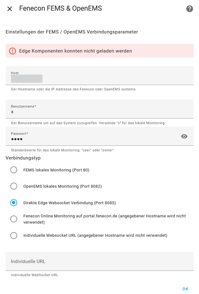

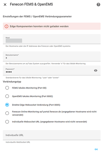

today I tried to migrate my Fenecon2mqtt installation to the HA_openems addon, but I’m getting an error: “Cannot read edge components” when adding a new device with the IP of my FEMS:
In the FEMS log, the following error message appears when I try to connect:

I also tried the local monitoring connection option with the same result.
Any idea what the problem could be?
