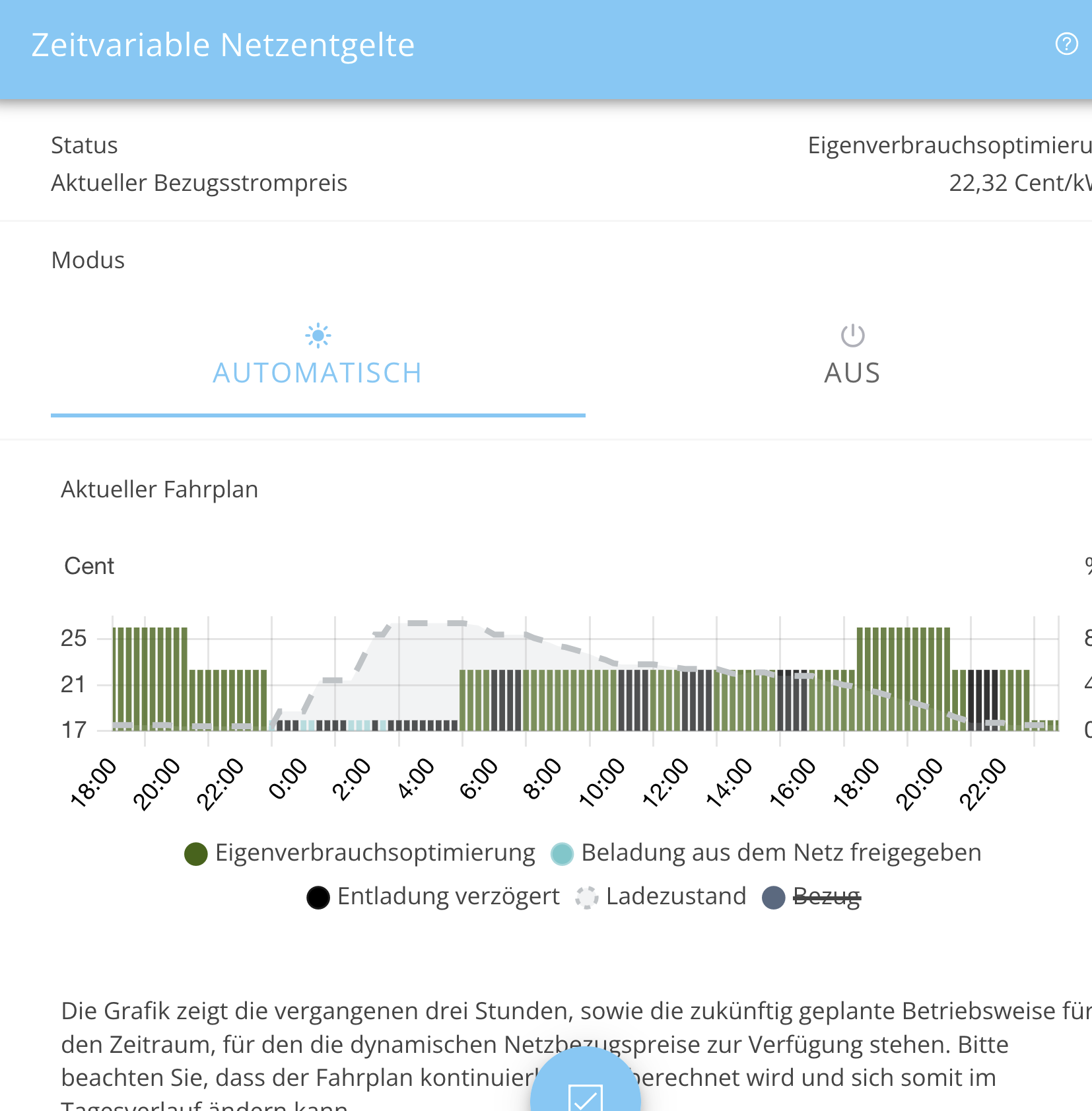

FEMS has this logic build in (APP zeitvariable Netzentgelte and similar):
to reduce battery load, the charging is limited, so that at the end of the time-window the intended soc is reached.

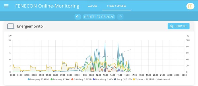

Example (same day):
• FENECON:
• Production: ~23.4 kWh
• Consumption: ~26.6 kWh
• Grid import: ~10.5 kWh

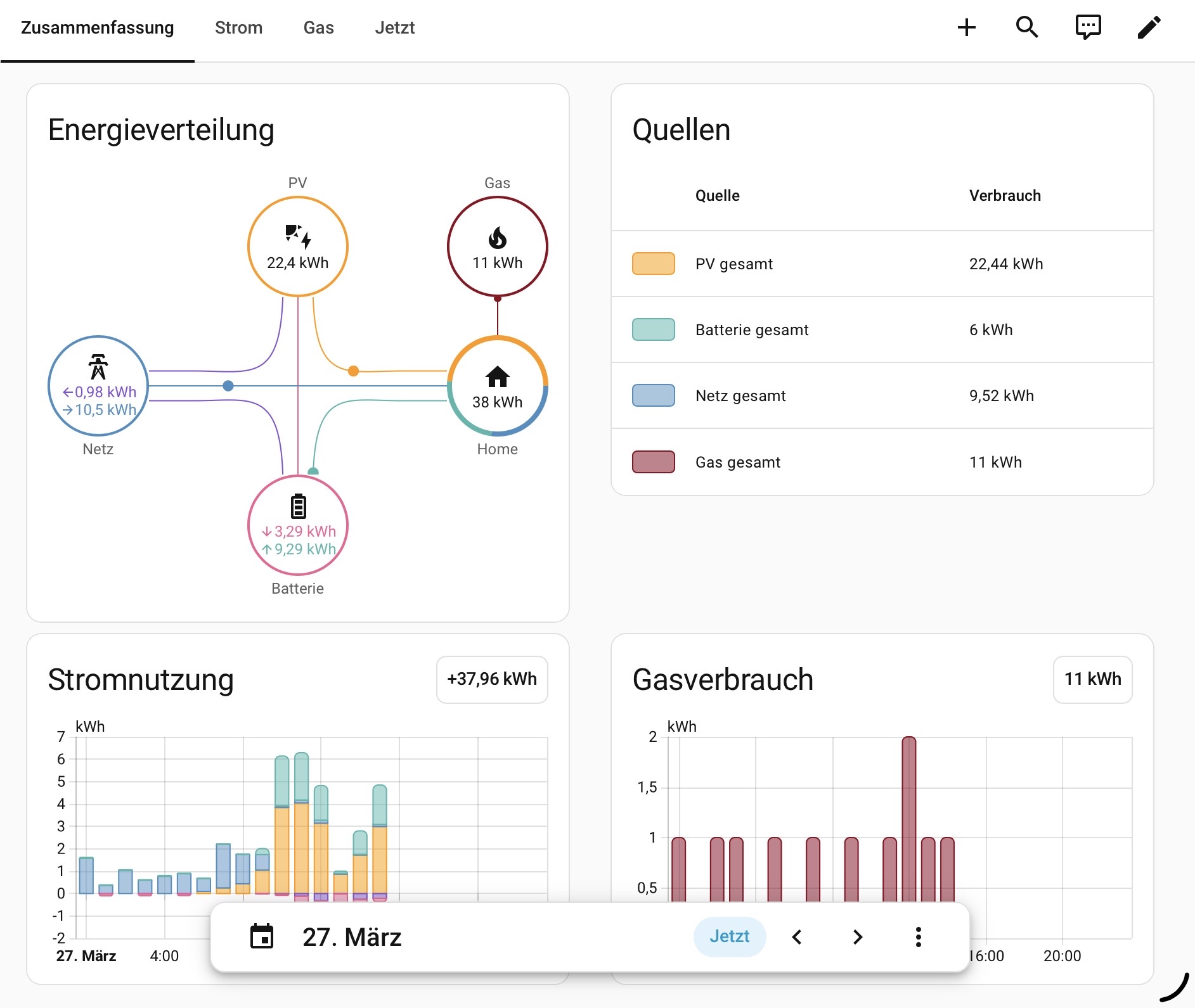

• Home Assistant:
• PV: ~22.4 kWh :white_check_mark:
• Grid: ~9.5 kWh :white_check_mark:
• Home consumption: ~38 kWh :x:
So individual values look correct, but the overall energy balance is off.

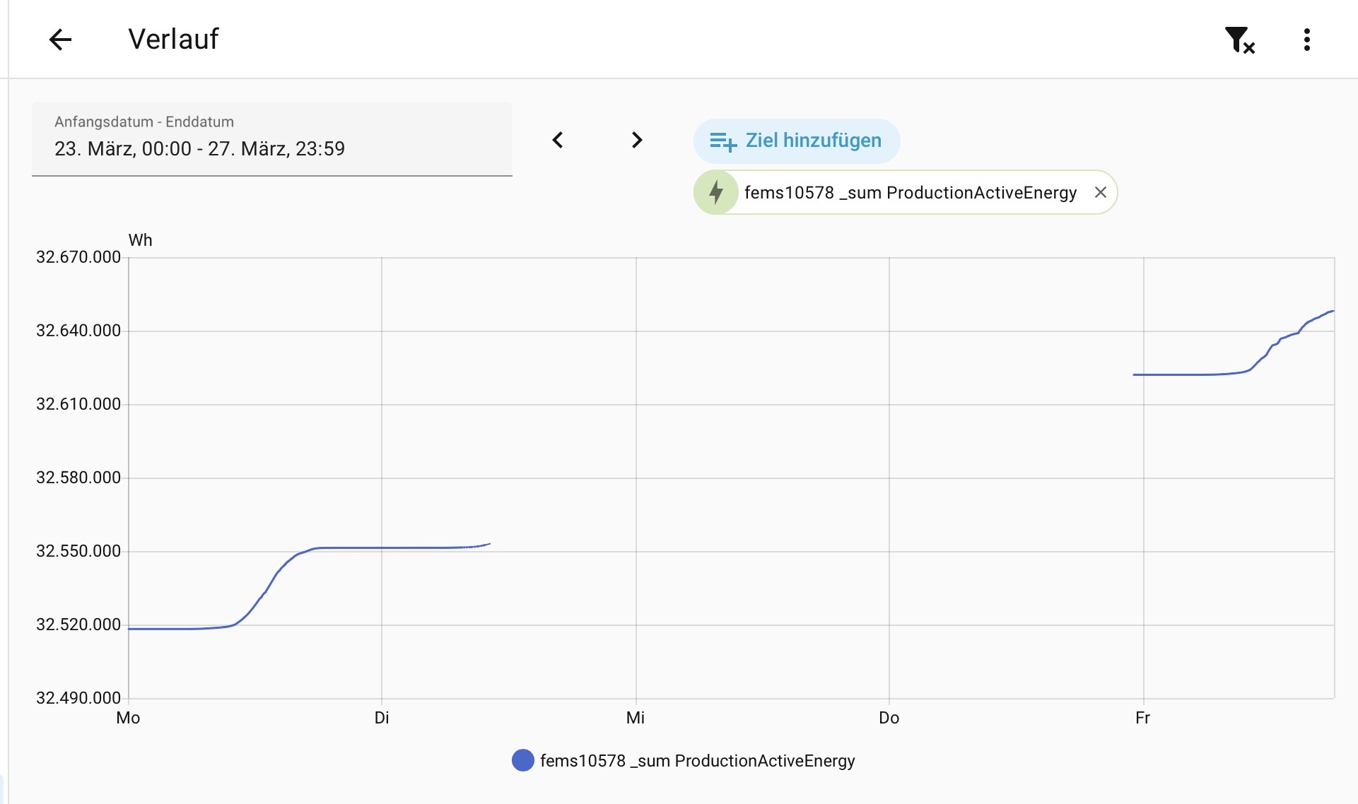

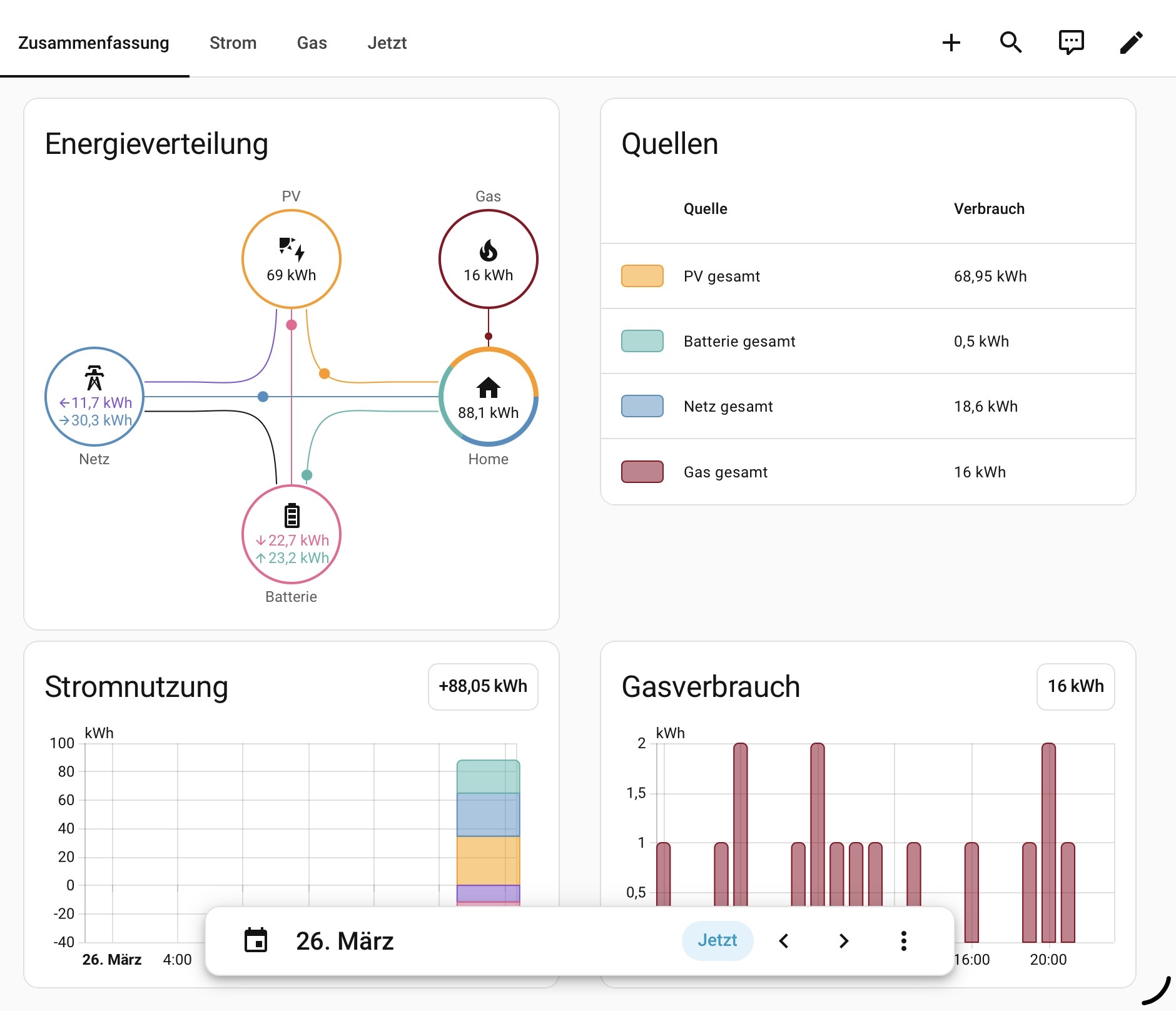

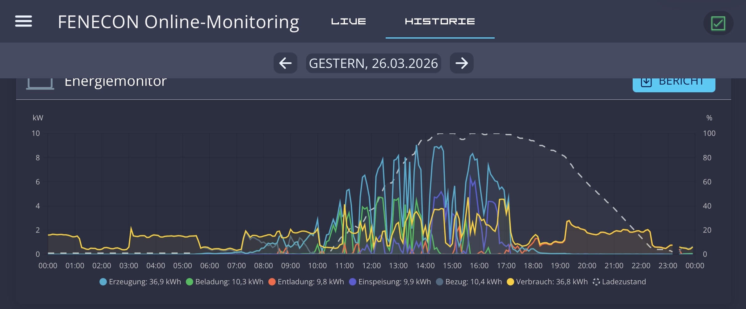

Looking at your screenshots (eg taking the one of March 26th), I am surprised about the discrepancy in the PV production.
  • FEMS: 36.9 kWh
  • HA: 68.9 kWh

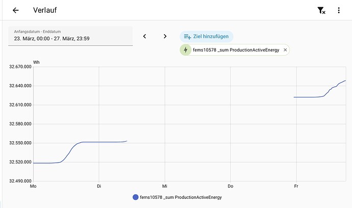

How does the chart of the *_sum ProductionActiveEnergy entity look like for that day in HA?
That might actually be related.
On March 25th I did not receive any data from the system, and the values seem to have been updated only on March 26th.
However, I had already checked the raw sensor values before and at that time they appeared consistent with the FENECON portal.
What I’m seeing now is:
• The individual sensor values look plausible
• The curves are smooth (no visible resets or spikes)
• But the total energy for the day (especially PV production) ends up significantly higher in Home Assistant
This makes me wonder if delayed or backfilled data could be affecting how Home Assistant interprets the total_increasing sensors.
If a larger increment is applied after a period without updates, it might be assigned entirely to the current day, which could explain the discrepancy.
Would the integration or underlying system ever “catch up” missing values in this way?
I will also take a closer look at the sensor history around the day boundary to see if there is a noticeable jump.
Happy to provide additional charts if that helps.
So basically you received the energy of 2.5 days Friday very late. This is the reason why the values do not match.
So we can only use the data of today for meaningful evaluation.
For todays values: Is it possible that the 38 kW consumption is exactly the sum of the consumption visible in FEMS (26.6) + the gas consumption (11)?
What do you expect? Do you say that the 11 should actually be included in the 26.6?
Thanks – this helped clarify things a lot.
I checked the values again for today and they actually match very well:
  • FENECON:
    • Consumption: ~46.8 kWh
  • Home Assistant:
    • Home: ~47 kWh
So the total electrical consumption is consistent.
The confusion came from the fact that in Home Assistant I also have a separate “gas” entity (~12 kWh), which in my case represents the heat pump.
However:
  • The heat pump is fully electric
  • Its consumption is already included in the total “home” consumption
  • The “gas” value is just a separate visualization, not an additional energy source
So there is no double counting – just a different way of presenting the same data.
Also, the earlier discrepancy (almost doubled PV values) was likely caused by delayed/missing data from the previous day being applied to the next day.
For today’s data, everything seems consistent.
