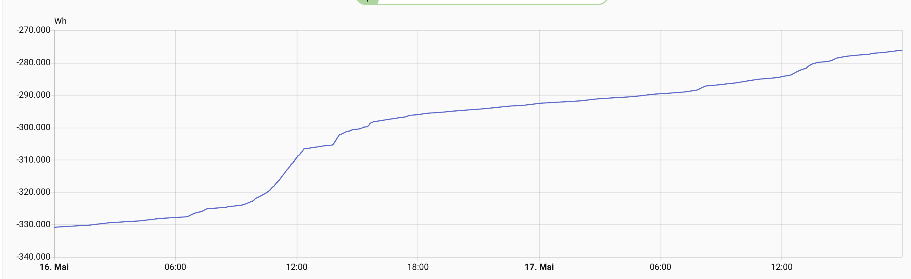

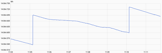

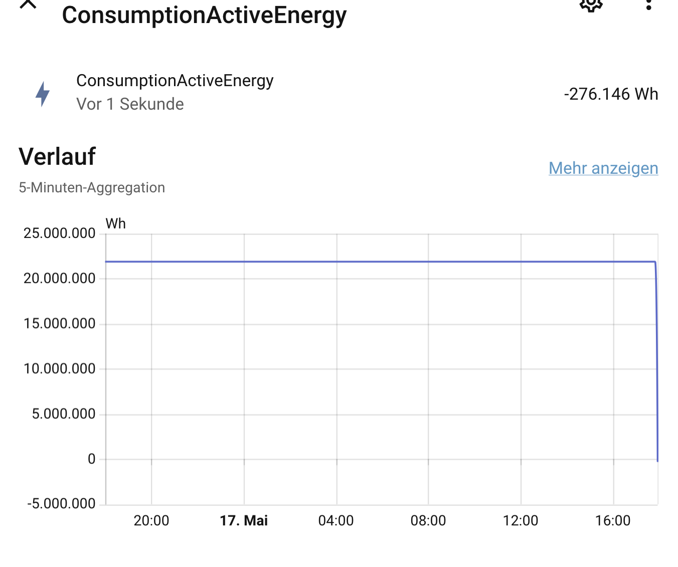

Primarily because FEMS sent zero (or even negative) values for the energy counters right after its runup, I am working on a behavior change to drop decreasing channel values for sensor which represent sum value (like _sum/productionactiveenergy and _sum/consumptionactiveenergy).
While testing this change, I see a weird behavior of the _sum/consumptionactiveenergy channel. This is how it looks to me:
Can somebody confirm this behavior?

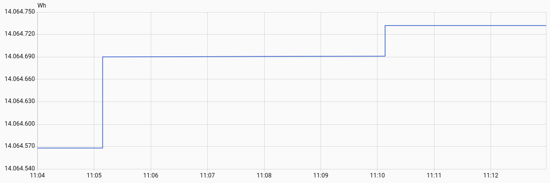

With my current change, behavior would instead look like this:
I still think this change would make sense. :face_with_raised_eyebrow: and would aim at rolling it out with a potential v1.6 of the integration.
Very strange numbers.
That's even more unexplainable than my system.
First chart looks similar to my system, with a super large dip when fems restarts. This is the main reason for me to add the change I explained above.
Regarding the 2nd chart: never seen a long time negative energy counter before. Does not happen for my system.
