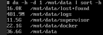

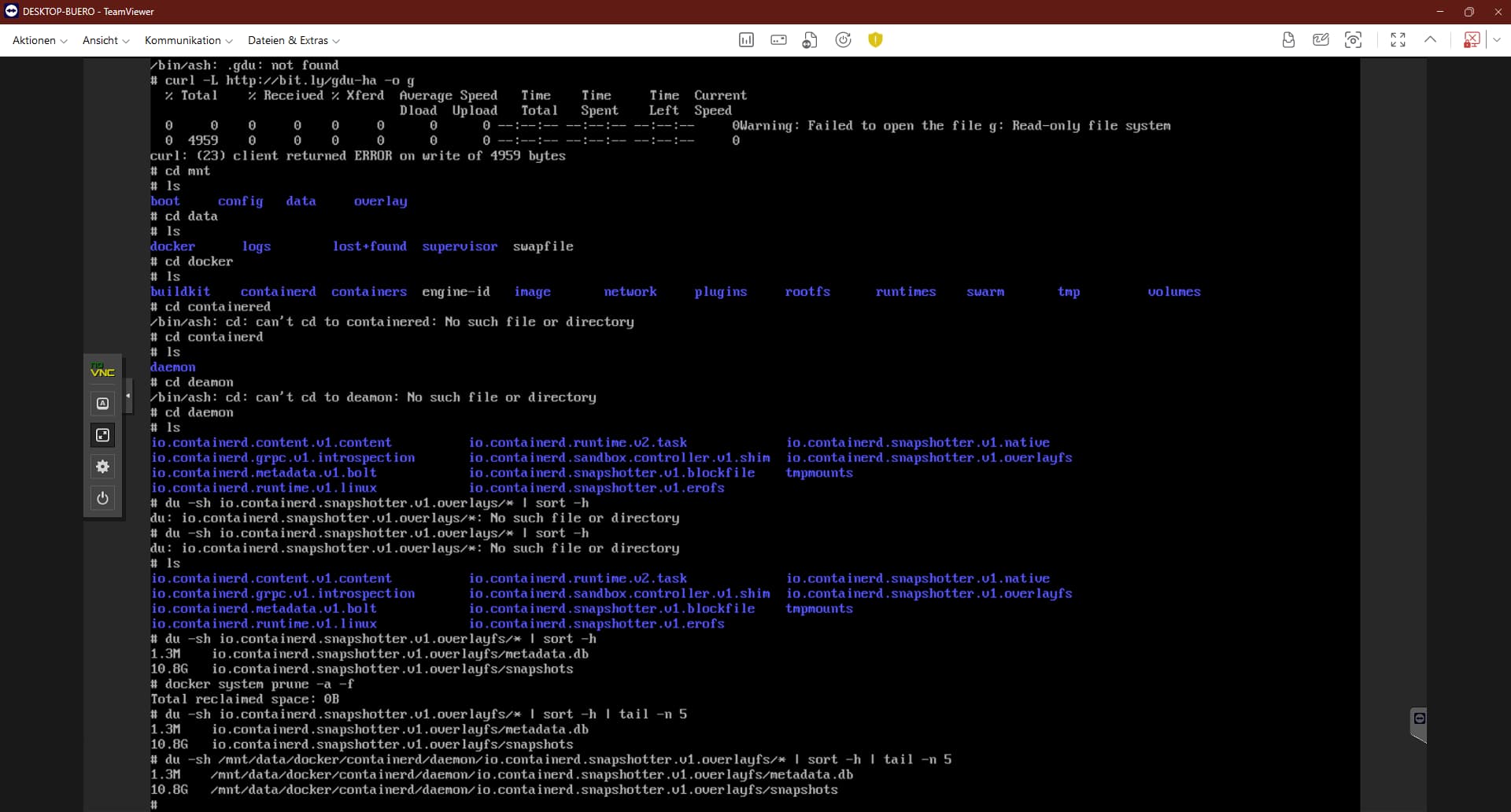

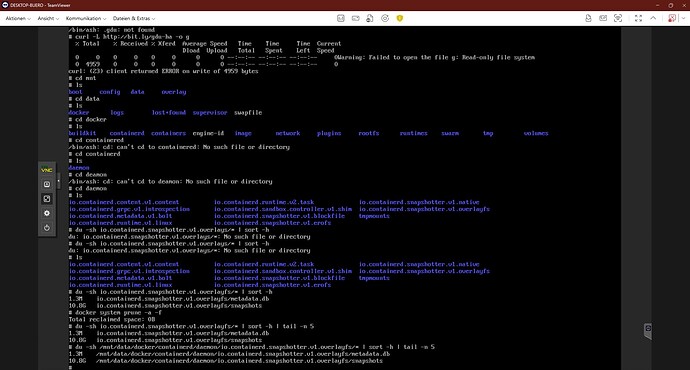

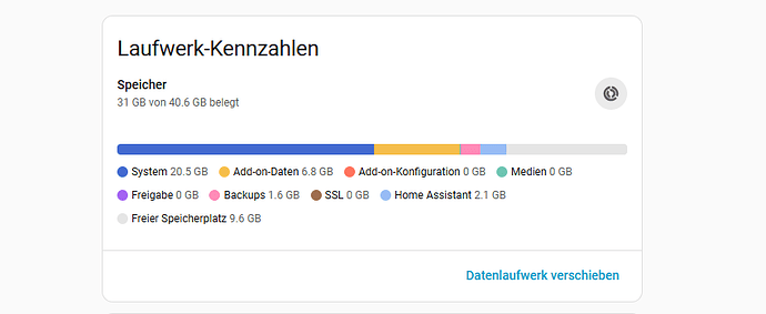

I think I have a similar problem. I also performed the migration, and my storage space keeps decreasing. I tried using AI to solve the problem, but I haven’t made any progress.
All I could find out is that the Docker folder is taking up 22.1 GB and the Supervisor folder 11.5 GB; those are the largest amounts.
And that the Snapshot folder within the Docker folder is very large.
