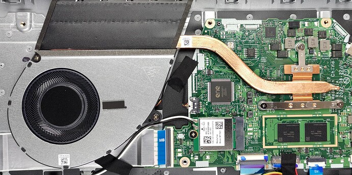

Perhaps if you could run it headerless, without battery,case, keyboard. You could add further heat sinks it might take pressure off the fan which will eventually burn out if run continuously. Add a 5V fan connected to USB port might work as a replacement.
or just raise the laptop from the surface with pcs of wood or if you want it to be more visually pleasing use a laptop riser with built-in fans
Exhaust/intake fans are on the back, bottom &/or sides. Keeping the lid closed for long periods will not adversely affect temperatures, assuming you haven’t placed the laptop on a blanket. Hell, just setting consoleblank will practically negate much of the extra heat it would generate, by virtue of not having the screen LEDs on constantly.
