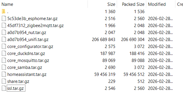

Nathan, if I knew exactly what was being saved, I could perhaps check if my changes were included. Is there a detailed description that specifies directories and files what is being backed up? Can I open the backup data and check, like in a browser (using WinRAR), whether the correct data is in the backup? If so, that would be the solution. The best solution. It’s the uncertainty that makes me want to clone the SSD. I haven’t made many small changes outside of the system. They are all documented. But my experience has also taught me that a lot can go wrong in the rush. A clone would be the “one-step solution” without many potential pitfalls.
Yep. If WinRAR doesn’t get you there, 7zip definitely will:
Just make sure the backup is unencrypted so you won’t have to deal with encryption keys to open a local file.
PS - I can also confirm the entire SSL folder (including certificates) is included in a full backup.

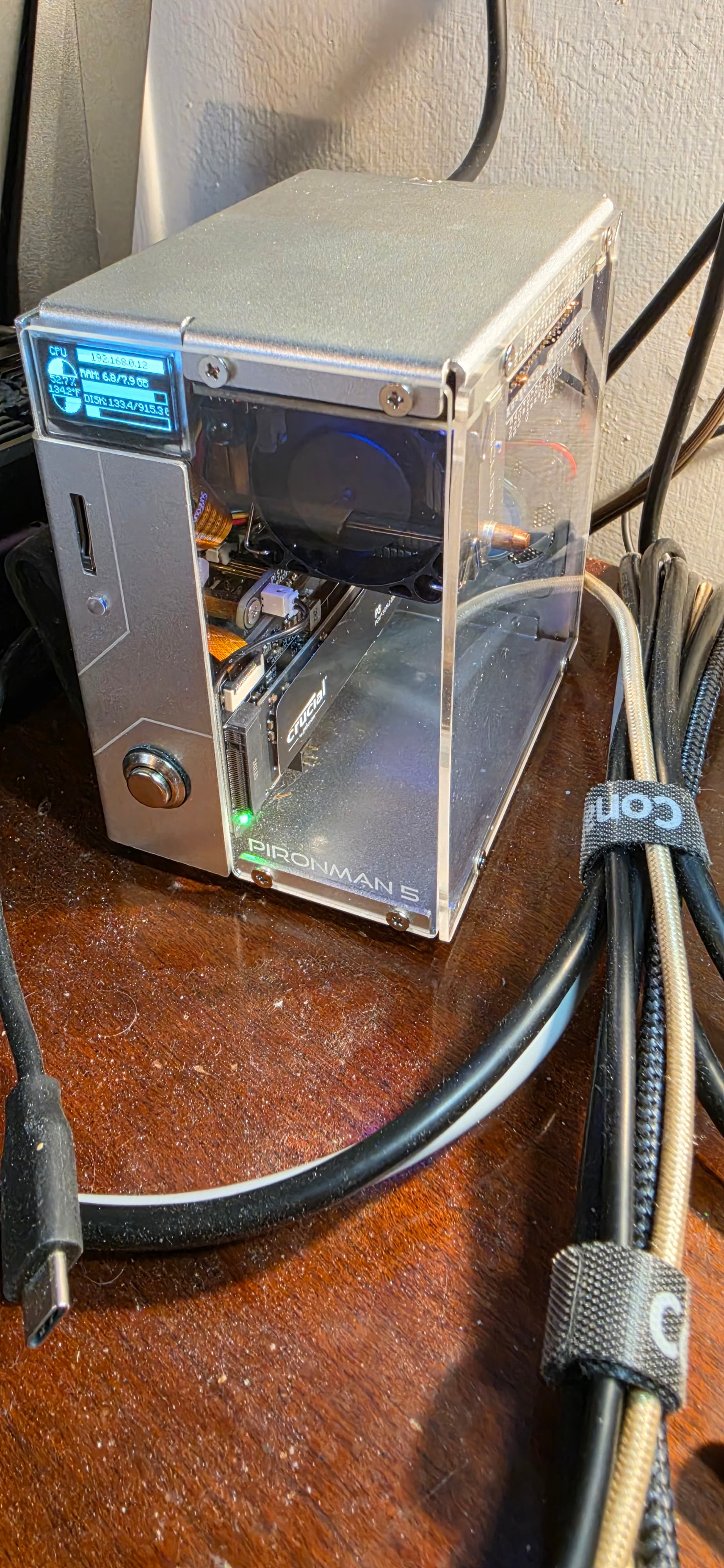

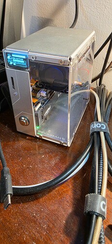

So is mine (PrironMan 5), see the photo, I notmally boot up from the SSD as well. When I am booting up from the MicroSD I make sure nothing is running on the internal SSD, plug in an external one on a USB port, both are visible, and I then use the SD Card Copier (both appear there). No need to open any case.
Quick note for the SD Card Copier, all SSD's/NVME's/SD Cards I believe appear with the name of the model. In this case it is a non-issue and the internal one is marked as NVME, but if you are doing this with two SSD's that are the same model, I believe there is no way to tell which is which at the source and destination selection time!
