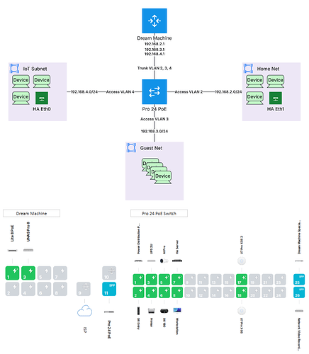

I am currently in the research phase of trying to design my home lab/network and I am getting a little stuck with the HA stuff and would appreciate a sanity check before spending any money. My primary background is a software engineer but lately I have been getting into networking, and I have found doing hands on is the best way to learn.
In my home lab I have a Dream Machine Special Edition and I am currently looking at hosting HA OS on a Raspberry Pi Compute Module 5 with the mini dual gigabit ethernet mini computer kit from Pi Shop (can't link due to new user restrictions). I would like to have three different VLANs:
  1. Home Net:
    1. Has access to the HA dashboard via the secondary HA interface. This interface will be statically assigned.
    2. Has unfettered access to the internet.
    3. This is where the cameras/NVR will live. Can access the camera recordings either directly from the NVR or via a HA dashboard.
    4. Work Station/ TV/ Game consoles.
  2. Guest/Child Net:
    1. Does not have access to the HA dashboard.
    2. Internet access has QoS and DNS filtering.
  3. IoT Net:
    1. HA talks to the IoT devices via the primary interface.
    2. Internet access has QoS and Netflow monitoring.
I've seen a few other topics discussing this but they either seem aimed at keeping the IoT devices offline or are outdated:
WTH, I can’t tell HA which network interface(s) to advertise the mDNS domain on/which is default (cant link due to new user restrictions)
Utilizing multiple network interfaces to keep hardware offline and HA online
HassOS with multiple network cards
One solution detailed in HassOS with multiple network cards looks to be depreciated. The other solution of using inter-vlan routing but using ACLs could be a solution, but I'd rather block all inter-vlan routing and I don't want the traffic from my home net getting caught up in the netflow monitoring.
From my understanding I should be able to have HA's primary interface live in the IoT VLAN and do all of the normal DHCP/DNS stuff with out issue - almost as if there were only one interface. But then have the second interface live in the home net with a static address, so when I then use the unifiprotect integration HA will (hopefully) be smart enough to see those devices are accessible via the secondary interface. I would then also want to add the secondary interface to the DNS server on the home net to wrap things up.
If I am missing something glaringly obvious or if you have a more knowledgeable idea please let me know! Thanks in advanced :slight_smile:

If you have the dream machine, you can implement routing between VLAN’s and proper firewalling on that platform.
Linking multiple VLAN’s to a single server (HA in this instance) is a direct path to nightmares, both from a configuration, monitoring and security perspective.
Get the HA device online on either the Home Net or the IoT Net, and use the routing / firewall features of the Dream Machine to link this all together.

I’m starting to lean more towards just having the router do its thing and have a single interface, but to answer @oldsurferdude I am trying to:
  1. Segregate the IoT device from the rest of the network. With how unsecure some IoT device can be I don’t want them to be able to access my NAS, NVR, or other client machines. My initial thoughts were that if the HA server had a leg in both subnets it would be reachable/ can reach the desired devices but the other IoT devices would be kept in their own lane. As @pshemk points out HA is effectively a Linux box and won’t natively route traffic.
  2. In that same vein I’d like to set up a netflow monitor to see where the IoT devices are calling out to, but I don’t want to capture traffic from other users or internal to internal.
  3. I’m also trying to learn! I’ve worked with networks in a Devnet role for a while but haven’t gotten a chance to work hands on with some of this stuff. I’m currently working on getting the CCNA so not totally unfamiliar with these topics, but would love to have a home lab to try things out.

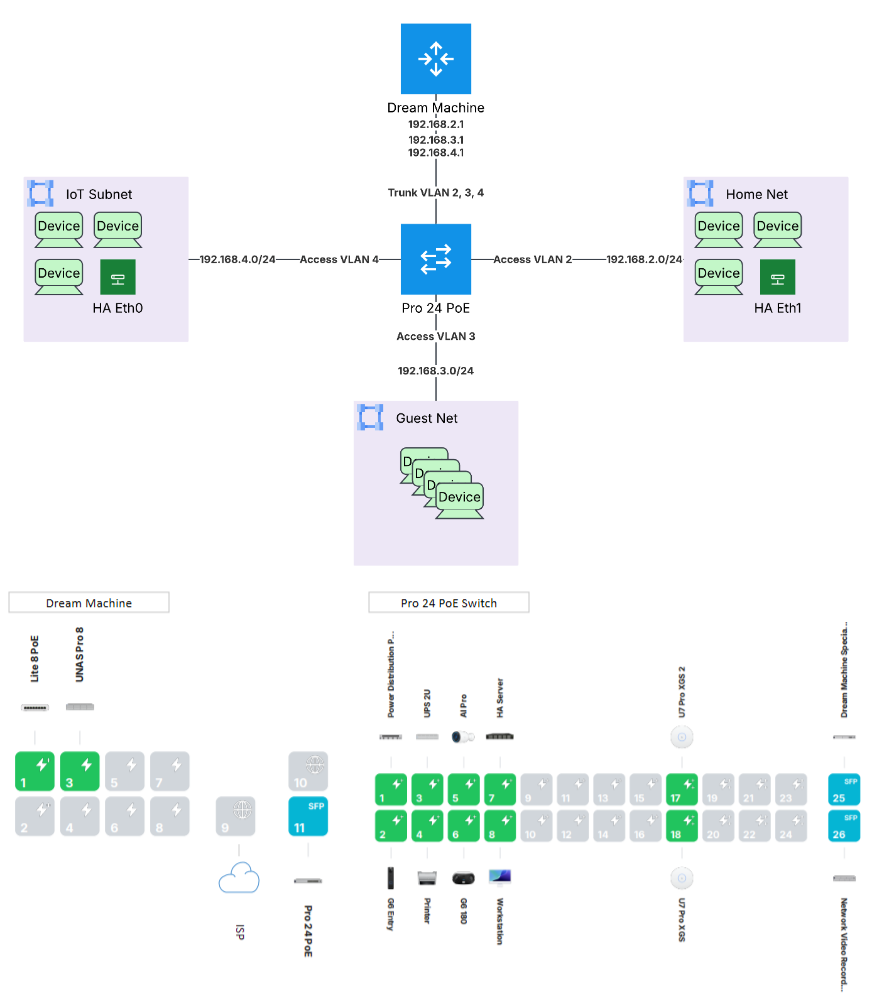

For more background here is my high level diagram of how I’ll be connecting everything. In this configuration the Dream Machine will act as a router on a stick. And, for completeness here is also how I plan on cabling things (if I do multiple interfaces port 9 on the switch will go to the eth1 on HA server).

Out of curiosity why do you have multiple interfaces, interested to know if there is another benefit to having two interfaces that I’m not seeing?
Also why have both interfaces set with a DFGW? From my understanding that’s something you never want to do because it can cause some odd behavior.
3 suggestion readings…
Get HA on the IoT network with all the other IoT devices.
This will gather all IoT devices in one network and it will just work.
Putting HA in another network than the one with the IoT devices will cause issues, because broadcasts are not routed and standard IP firewalls and routing will not help here. Broadcasts are not meant to be routed by design.
Would this then imply that the cameras should also be in the IoT subnet or could I route HA to the NVR? I’d prefer to keep the cameras and IoT devices on different subnets if possible.
Unifi has often been mentioned in networking related problems reported here. Be sure to adequately understand the default settings and options for the vast range of options on offer from this popular vendor.
Your challenge to solve some of these challenges is not just Linux or HomeAssistant specific as suggested by others - it goes right down to core network basics and fundamentals, as your CCNA studies will uncover and give you deeper insight as to my earlier warnings.

I have my Home Assistant Instance running multiple interface (manually through terminal) using VLAN tags, no router involved here. Everything communicates directly to the devices, HA acts as a DHCP Server and DNS server.
The only caveat here is mDNS, it only works on primary interface that have active internet connection (or have a gateway IP). So having that nice auto device detection may not work on IoT/IP camera vlans.
Technically mDNS should be working on all interface but alas, HAOS as a whole is not really designed to work with multiple networks, its funny given HAOS has this reputation being flexible but this is one part that they did not improve yet for almost a decade now.
Well, in your setup maybe.
The caveat is the discovery protocols, which pretty much all require some broadcast packets to work.
mDNS is the most common one, but there are others, like SSDP, ZeroConfig and uPNP, which are the just the open standards. There are some closed standards too.
mDNS often have a proxy (also often called a reflector) available.
The other protocols are harder to solve and especially the closed ones can be next to improssible.
What a person need for their setup is totally depending on what devices they have chosen to use, so there is no general solution.
The maintainers of the setup need to know and understand this themself, both at the initial setup point, but also later when new devices are bought and implemented.
HA use the general Linux solution for mDNS and just making it available on all interfaces is not that simple.
Entries can flip-flop and cause havoc if they are used on multiple networks and it is not uncommon for modern routers to provide services over mDNS with the same name on all networks, so it is not an uncommon situation.
The issue is something the devs of the mDNS service can not handle in code.
It has to be the network owner that configure their devices in the right way, which is just not a skill and knowledge many have, so it is better not to open that option.
The wifi network my HA is on is effectively a ā€œstubā€ network - devices there can’t get to the internet. The wired network is the ā€˜regular’ network.
Both interfaces show up with default gateway because on both of them IPs are allocated using DHCP - a linux host will automatically set a default route there. But because by default wifi interfaces get higher metric (which means that they’re lower in terms of how ā€˜good’ it is) - the HA uses my wired network to get out.
Using multiple subnets and routing traffic towards/from HA is doable, but you’ll lose the autodisovery feature provided by many integrations (which rely on multicast packets used by SSDP, mDNS and others). If you’re ok with manually adding your devices using their IPs - you can use a routed network, but from my experience that only works well if you statically allocate the IPs (for example by mapping MAC addresses to IPs on your router, which is likely to be the DHCP server as well).
I personally decided it’s much easier to just give HA direct access to the network where all those IoT devices live.
Remember that not all integrations provide an option to use IPs, so going this way will exclude some device options.
