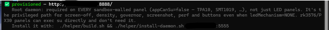

How do I direct the script to install the pre-release versions and not the latest signed version?
Also, please can you expand on how to complete this step:
Install it with: ./helper/build.sh && ./helper/install-daemon.sh 192.168.###.###:5555
As of v0.9.0-rc5, just add --prerelease and the installer grabs the latest build; release candidate or newest stable:
curl -fsSL https://raw.githubusercontent.com/maxlyth/ha-paneld/main/scripts/install.sh | bash -s -- --prerelease
Also works for scripted installs: ./scripts/provision.sh <panel-ip>:5555 --prerelease
I am going to release 0.9 stable in the next hour or so. I need to change a fair amount of documentation to explain the new direction so I am just trying to get that coherent.

Sorry to keep asking, but is there a one line install for the Helper Daemon? The result of the install script seems to imply that I can install it but when I have tried various commands, it has failed:
I seem to remember your panel is unusual as it is a tablet non-rooted device as opposed to most panels that are delivered rooted. There are ways to root such a device but that is normally the realm of phones and tablets so I don’t want to confuse people by talking about solutions such as Magisk which is never a fun experience.
I did come across a potential workaround called the Shizuku model that gives a large subset of root-like capability without root but I don’t have a panel to test it on and I am focussed on getting the features together to support the majority of users with Sonoff/Shelly/Tuya type panels.
I have made a note in my backlog but probably won’t get to until past the release of v1.0. Sorry
