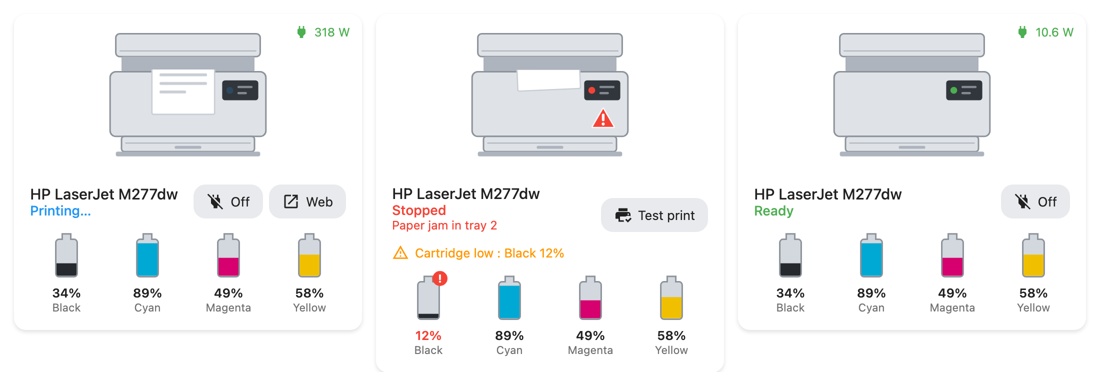

My printer in Home Assistant was four percentages and one English word. It worked, it was ugly, and I still had to walk over to the machine to know whether it was doing anything.
So I drew the printer. While it prints, a sheet slides out on a loop and fades as if someone took it. A paper jam leaves it stuck half way with a warning triangle. Toners are drawn in their own colour instead of grey bars.
Four machines, each ejecting the page where it really does: an all in one into the recess under its scanner, an inkjet from its rear tray out the front, a laser onto its roof, an office multifunction into the bay above its drawers.

  • The low threshold is 20 %, not the marker_low_level printers advertise. They say 3 %, which is the point where pages come out streaked.
  • If you have a smart plug, printing_watts flips the card to printing as soon as the draw goes up. The ipp integration polls every 60 seconds, so a one page job starts and finishes between two polls and you never see it.

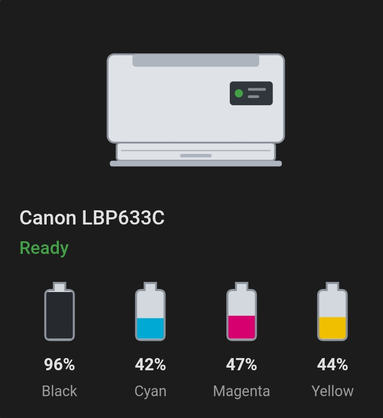

Not bad :ok_hand:, few things come to mind:
  • make clickable entities so it can show history
  • url isn’t fetched somehow. On device page it has an URL, not sure how that exposes
  • state on printer is ’ idle’ , how does it map to ready on the card?

idle vs ready. The card reads every integration’s state through one keyword table and shows a single label, which is what lets it work with ipp, Brother, SyncThru, HP, Epson, SNMP and Dell without any configuration. idle, ready, online, normal and standby all land on Ready, and so do their translations, because a Brother says one thing and a Samsung another for the same machine doing the same nothing.
Fair criticism though, since the mapping was invisible. So: the raw state is now the tooltip on the state line, tapping that line opens the entity, and both READMEs carry the full table. state_map overrides any of it if you want your own wording.
