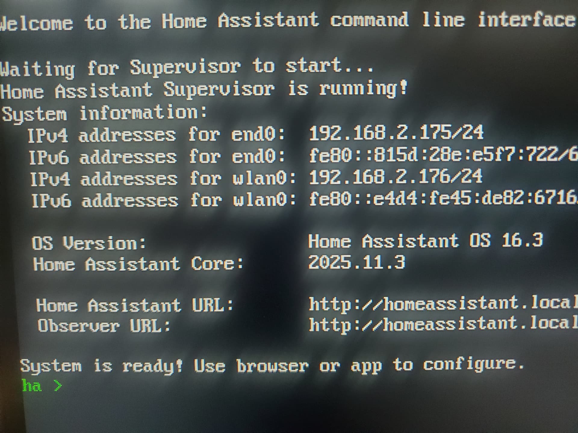

What does the monitor output on the HA server tell you?
sytem is running, IP addresses, etc.
You have both WiFi and Ethernet connected.
Both connection will then try to claim the homeassistant.local address.
No idea if they will eventually resolve it, but my best guess is they will keep fighting each other.
then connecting to 1 of the ip adresses (instead of hostname) would work.
