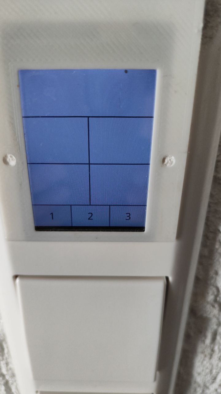

since 2026.3.0 the HASPOne doesn´t work :frowning:
it shows only the blank Page layer
Project should still work fine on 2026.03 (have a dozen here working as expected). Check for duplicate devices and then re-run first time setup as described here: Fix common HASPone issues ¡ HASwitchPlate/HASPone Wiki ¡ GitHub
Try recycling the power to the HASP.

Since upgrading to 2026.3.1, all of my HASP plates exhibit this problem.
Re-run Core functionality gives this error:
New automation setup timed out
Your new automation was saved, but waiting for it to set up has timed out.
This could be due to errors parsing your configuration.yaml, please check
the configuration in developer tools. Your automation will not be visible
until this is corrected and automations are reloaded. Changes to area, category,
or labels were not saved and must be reapplied.
UPDATE
Restored a backup (2026.2.3) and all HASP units are working again.
