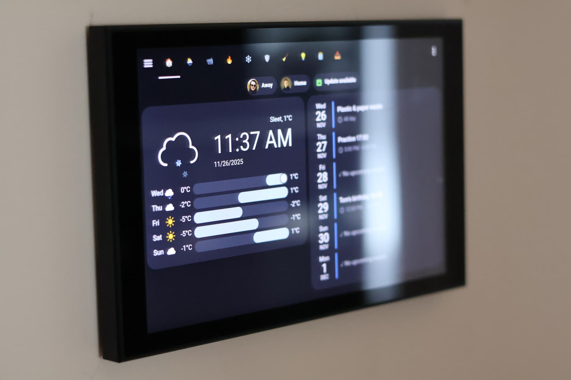

Hi everyone!

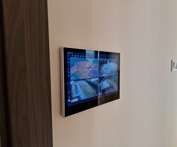

For quite some time now — mostly in the evenings — I’ve been developing a dedicated display for Home Assistant. The idea was born from the need for a stable, convenient, and visually appealing device to serve as a central control panel at home. I now have a working prototype that fully meets my expectations — and it’s already mounted on my wall :blush:
What makes this device different?
:small_blue_diamond: Custom Android (AOSP) system optimized for Home Assistant:
  • Home Assistant Companion used as the system launcher,
  • Custom HA boot animation,
  • Tweaked system navigation (Home button always returns to HA),
  • No standard Android UI — no accidental exits or system interruptions,
  • Added native SIP client for intercom support,
  • Lightweight OS with no bloat or background services — 100% HA-focused,
  • OTA updates supported.
:small_blue_diamond: Truly Plug & Play experience:
  • No kiosk mode, no rooting, no third-party hacks,
  • Just connect to power and network — it boots directly into Home Assistant,

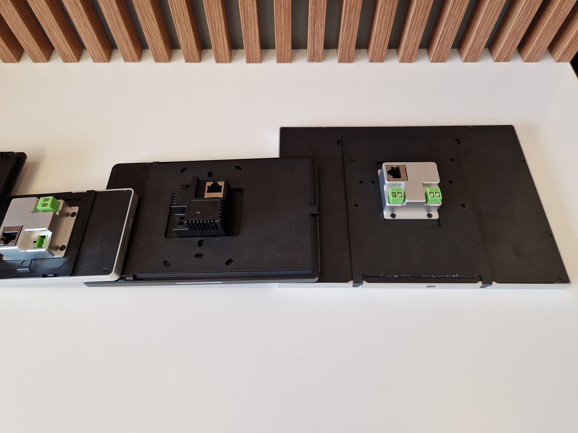

  • Hardware designed for wall mounting,
  • Powered via PoE.

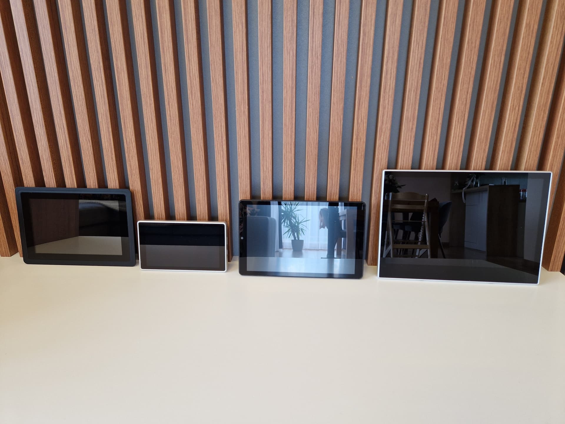

:small_blue_diamond: Available in multiple screen sizes:
  • 5.5", 7", 8", 10.1", 14" (HD or FullHD, 4GB RAM, 32GB ROM),
:small_blue_diamond: Experimental feature: running Home Assistant in Docker directly on Android — technically possible, but currently more of a testing than a production-ready setup.
Why not just use a modified tablet?
:white_check_mark: No unnecessary background apps or services,
:white_check_mark: No forced firmware updates that may break your setup,
:white_check_mark: No fiddling with kiosk tools, custom launchers, or system overlays,
:white_check_mark: No manufacturer limitations — full control over hardware and software,
:white_check_mark: Custom-built for wall integration, SIP support,
:white_check_mark: Fully prepared out of the box — just plug in and go.
I’m currently working on optimizing system and app performance, especially after prolonged standby periods — the goal is to prevent unnecessary full reloads after unlocking.
Log analysis (Android & HA server) shows just a disconnect()/connect() cycle on the socket layer, but I plan to dig into Wireshark traffic to better understand what triggers this. If anyone has experienced this or knows the cause — I’d love to hear your thoughts.
What’s next?
  • More performance and UX improvements :rocket:,
  • A larger 15-inch+ screen model,
  • I’m considering commercializing the project, but that depends on demand and how much time I can dedicate (for now, it’s a side project).
I’d love to hear your thoughts, suggestions, questions, or any constructive feedback. If this project interests you — I’ll be happy to share more updates and behind-the-scenes content.
:link: Learn more about the project and checkout the video: www.emel.tech
Best regards,
Patryk Czarnota

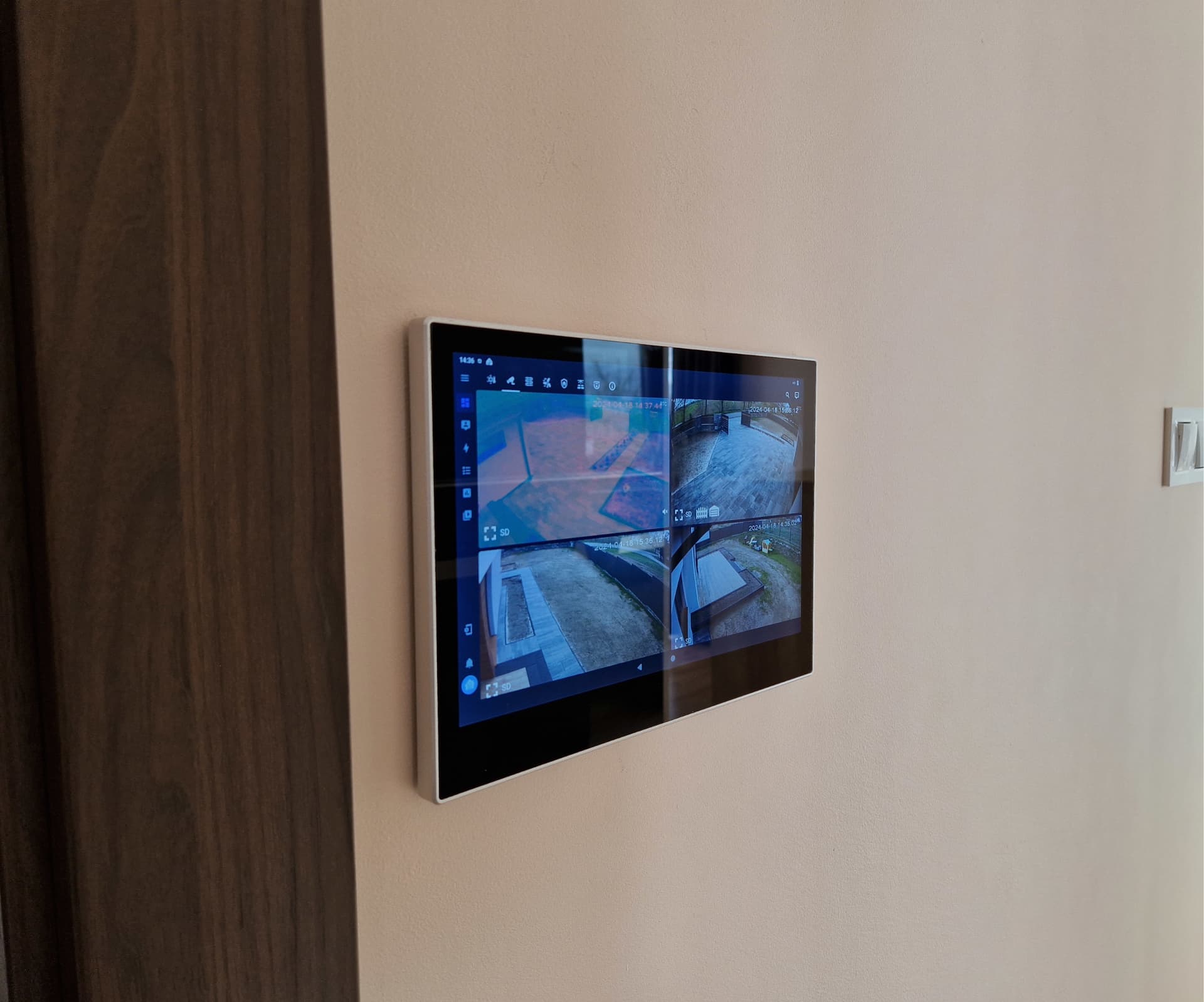

🔧 New performance tests – 8-inch PoE tablet with an 8-core CPU
After implementing the latest improvements in my HA Tablet with personal AOSP system, it was time to run tests on the new 8-inch model with an 8-core processor and PoE power.
📱 What’s shown in the video:
I prepared a short demo where you can see:
  • lightning-fast switching between tabs and panels,
  • smooth overall performance,
  • stable live view from 4 cameras,
  • a full-screen windy.com iframe test — even though it’s one of the heaviest resources you can embed inside a WebView.
🎞️ https://www.youtube.com/watch?v=Q1SP8AiYZIU

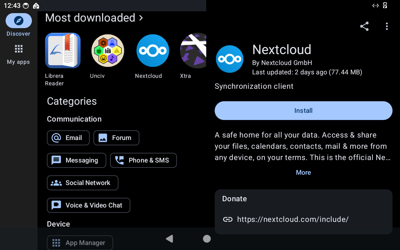

:airplane: OTA Updates, Custom F-Droid and the Start of User Testing
Until now, one fairly obvious thing was missing: a proper system update mechanism.
HA Tablet is not a one-time image you flash and forget about. The system is constantly evolving, so OTA updates were simply necessary.
I set up my own update server, where I publish OTA packages. On the Android side, I wrote a small client app that checks for updates, downloads them, verifies integrity, and triggers installation. No workarounds, no manual updates, no adb.
This allows me to:
  • quickly fix bugs,
  • test changes on selected devices,
  • and make sure every panel runs exactly the system version I expect.
:package: Application Update Mechanism
At the same time, I launched a custom F-Droid repository, mainly to distribute:
  • my own applications,
  • modified tools tailored for HA Tablet.
The F-Droid client is preinstalled and configured to use my repository by default, but it doesn’t lock the user into a single source.
Users can freely browse and install apps from the official F-Droid repository as well.
I didn’t want to build a “closed system”. This is meant to be a Home Assistant wall panel — still Android, just optimized for HA.
