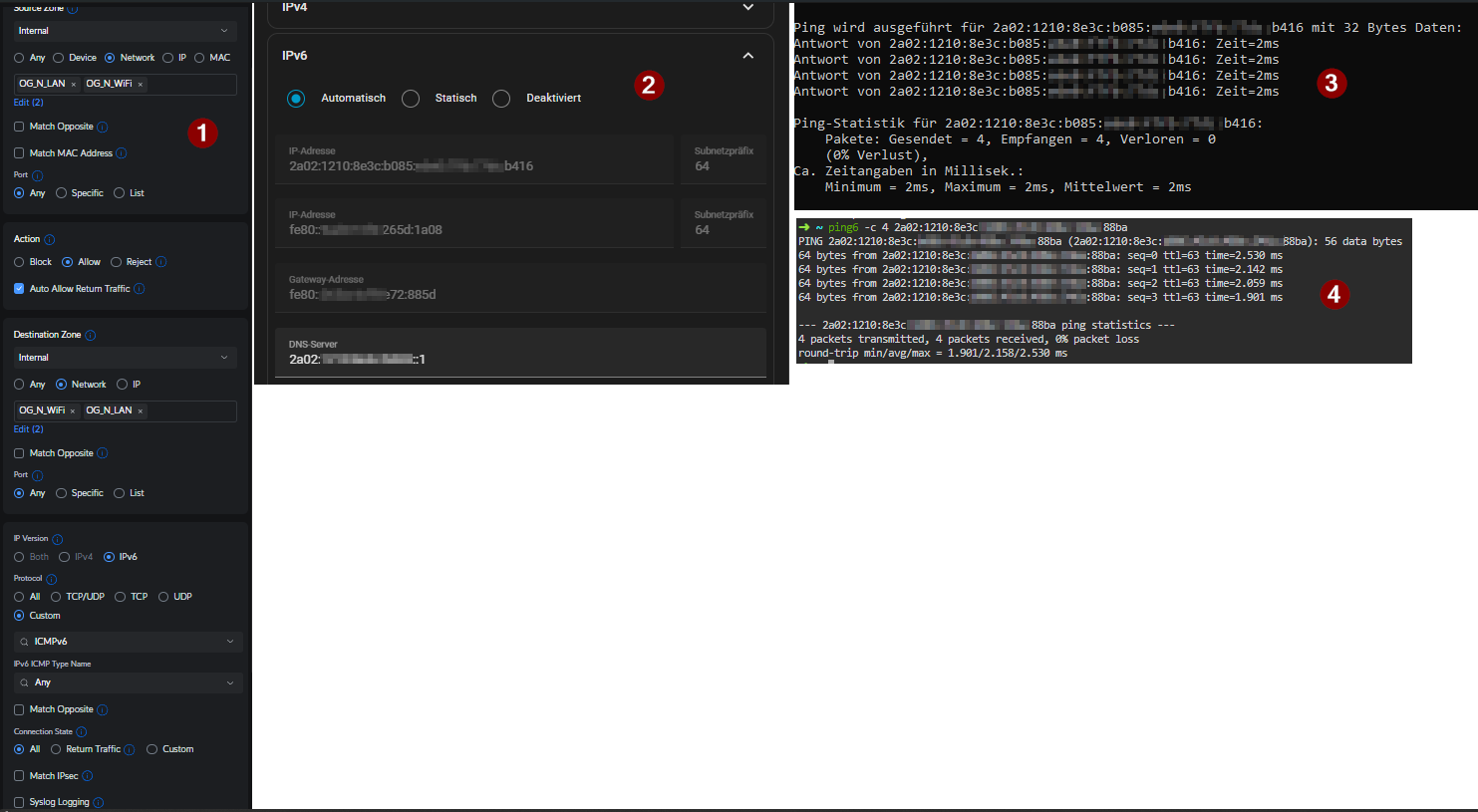

setup: unifi udm, 2 vlans (wlan - home assistant companion app, lan - home assistant itself), which have ipv4 inter-vlan routing allowed. furthermore ipv6 inter-vlan routing allowed (any types). (see 1)
home assistant ipv6 is active and set to automatic/dhcp. (see 2)
ping from vlan ‘wlan’ to ‘lan’ (thread border router) is possible. (see 3)
ping from ‘lan’ (home assistant, thread border router) to ‘wlan’ ist also possible. (see 4)

Having two VLANs is often the problem as the mDNS advertisements (which are heavily used in Matter/Thread) don’t get seen across VLANs.
Otherwise, see if this Unifi tip helps …
SOLUTION:
Mobile phone and Home Assistant need to be in the same VLAN. Even if the IPv6 communication is completely allowed between VLANs it won’t work…
