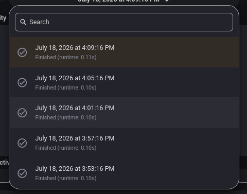

From a quick test using a basic State trigger limited to the elevation attribute, it looks like elevation is likely recalculated on restart and then every 4 minutes…
The same pattern holds true using the new sun.elevation_changed trigger.
Thanks, that’s very interesting.. and unexpected. So technically that means for that particular entity there is only a resolution of 4 minutes. But somehow I suspect there might be a config change somewhere that allows that frequency to be altered.

Based on the Task description for improvements to the new triggers, it seems like the solar-event based triggers may be pre-calculating the time for the next event then setting a time based trigger listener in the background.
Yep, that makes total sense, from my past experience with other home automation platforms, things like sunrise and sunset are calculated/updated just after midnight then used for subsequent automation conditions or triggers throughout that day. Based on the link you provided, it seems there can be offsets down to the seconds level, so that coincides with @parautenbach statement that HA probably has resolution as low as 1 second intervals if needed.

Interesting indeed. That explains the 4-minute update observation noted previously in the thread here, the PR explains why 4 minutes is optimal.
