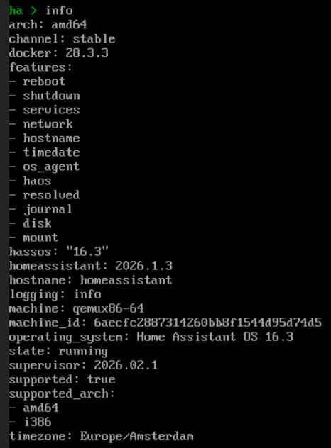

After every reboot I get a small window of an online system, but that takes maybe a few seconds and to little time to login and view log files. I tried viewing log files, but that is difficult with the Proxmox console. And I’m not sure which log files to check exactly actually.
I’m able to open the Proxmox console and execute commands, but up until now I’m not able to get anywhere that the system is responding again through the web interface.
