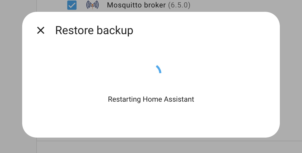

edit: honestly I can’t see any way to recover from this other than to risk it all and try restoring a backup, hoping that the MQTT database will come with it…
edit: That worked. I’m now back to having things properly associated. What the hell happened? Who on earth decided it was a good idea to give “devices” such precarious, unmanagable device IDs? I read about “oh, use Call Service instead of Device”, but why? The context there doesn’t make sense - I’m not “calling a service”, I’m referring to the state of a device. A device with a specific entity ID. A globally unique, human-readable entity ID. Why is it so difficult for the device picker to use THAT instead of these cryptic, unmanageable gibberish string IDs?
