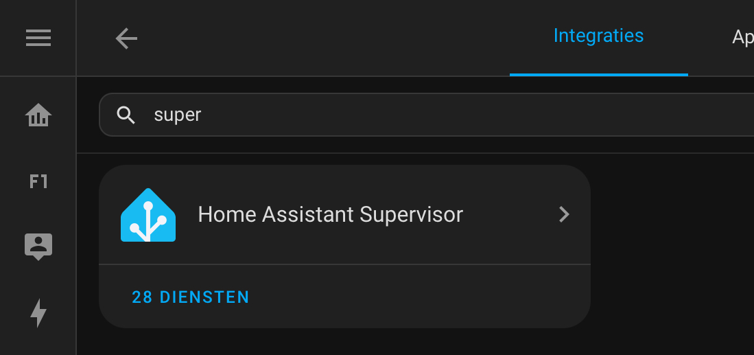

I am having the same issues on at T630 where exactly is this tab to turn on?

The integrations tab is in settings, where all the integrations are. Supervisor is one of them. If you open it you’ll see a service for each addon, with hidden entities you can enable.
