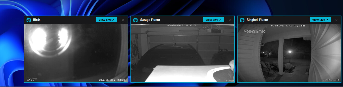

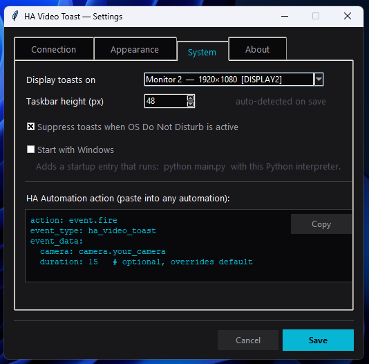

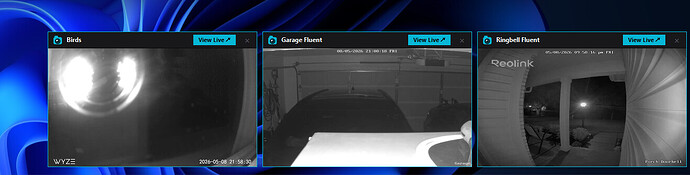

Features
- Live MJPEG video in the toast (streams from HA, no RTSP setup)
- Multi-monitor support — choose which screen shows toasts
- Corner selector — stack toasts from any corner of the screen
- Respects Windows Do Not Disturb / Focus Assist
- Full GUI settings — no YAML config files
- "View Live" button — opens the camera stream directly in your browser
- Start with Windows option
- Python + tkinter, lightweight
Screenshots
