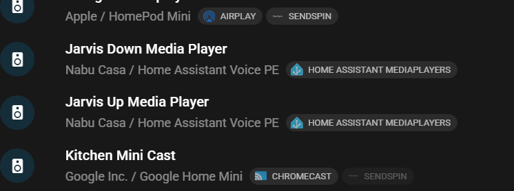

But I noticed the other day, that neither of my VPE devices show up as sendspin players.
I do have them as HA mediaplayers, and other devices are showing sendspin.

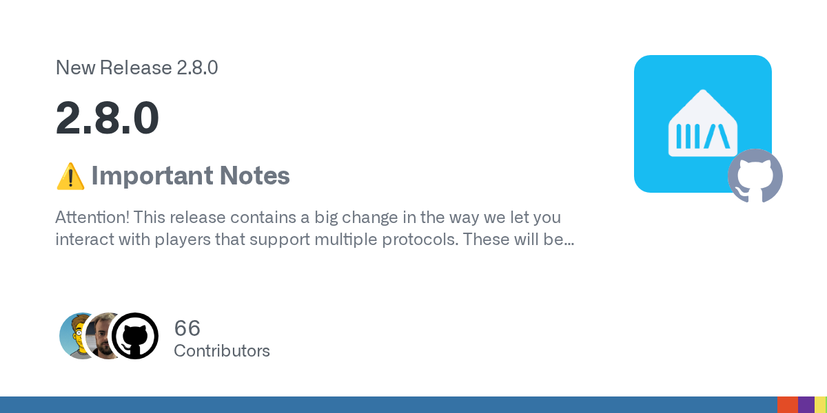

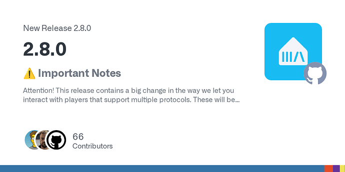

If you read the release notes for MA you would know that the players are now combined to help declutter the MA UI.
I know they are combined but as you can see in my screenshot, there is no sendspin protocol listed under the VPE

Nope still have the VPE's using HA media player, no send spin protocol indicated in the MA players for these devices. I'm running whatever the beta firmware (the beta slider in the vpe device setting).

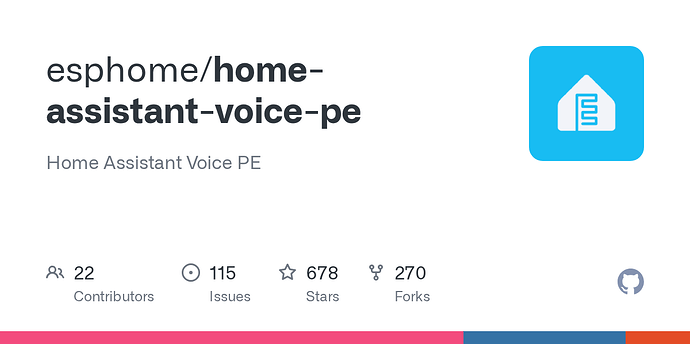

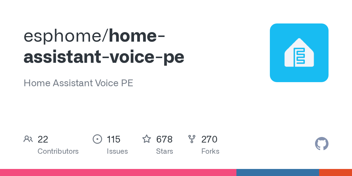

This is the firmware for VPE and sendspin, once installed it should provide sendspin players.
