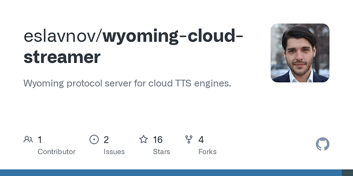

Find a custom component that implements the _process_tts_stream method for tts. Or use an external gateway. For example, this project.
Thanks for the specific tip! It now works with OpenAI, but it seems to be not very stable so far. Is there something similar available for Gemini?

Try Google’s TTS cloud service with this project.
Honestly, I don’t really understand why streaming synthesis hasn’t been added to the system G.cloud component yet. Apparently, few people need it.
It works, thanks! The quality isn’t terrible, but it definitely feels like a step down from the actual Gemini TTS voices, despite having the same names. At the moment, I think I’ll have to stick with ElevenLabs.
