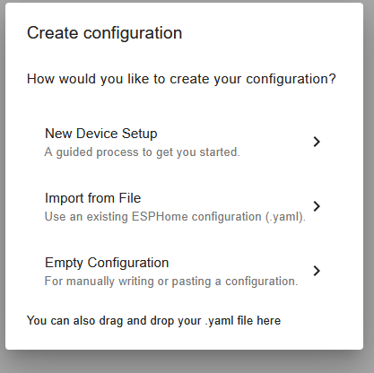

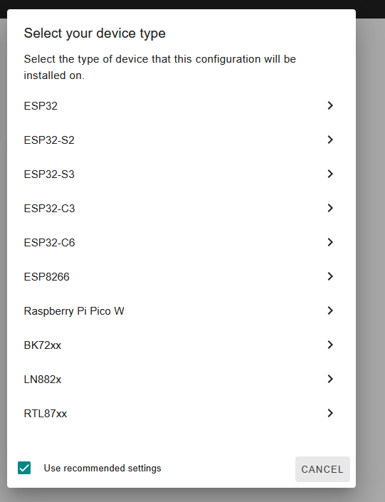

Add your Voice PE to ESPHome Builder (search Web on how to do it)
i think i have a different google… i think there are some files that need to be copied but it isn;t fully clear,
so what files to copy?
or…
how do i know the device
sorry if it is all straight forward, just getting confused at the moment
my voice pe is in the esp home integration, just need to get it to the builder some how
Found it… in the add-on in the top right you can click show discovered devices… then you can also take control…
