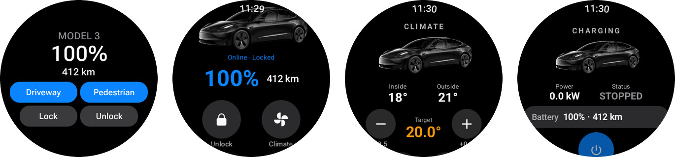

What it does
  • Main screen: status (online / asleep / charging) and lock state, battery and range, lock/unlock, climate, frunk and trunk, charge port and cable release, horn, flash lights, Sentry Mode, wake up
  • Climate: on/off, target temperature (limits read from your climate entity), window vent, presets
  • Charging: start/stop, live kW, charge limit and amps (the +/- buttons send one command after you stop tapping, not one per tap)
  • Tile: battery and range at a glance, fixed Lock and Unlock buttons, plus up to two one-tap buttons for a button, script, switch, cover or lock entity, for example a driveway gate
  • Complication: battery % on any watch face
  • Optional home screen: two gate buttons and two lights. If you don’t configure them, they don’t appear
  • Vibration and a message when the car confirms a lock/unlock, or when a command fails or gets no answer; a short “Sending to the car…” notification keeps it connected while a command runs
  • English and Italian
It is a remote control through Home Assistant, not a phone key: it needs a data connection.
