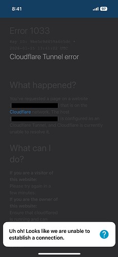

Problem: I have a Beelink for my HA server and I have it set to boot back up automatically if power is lost.

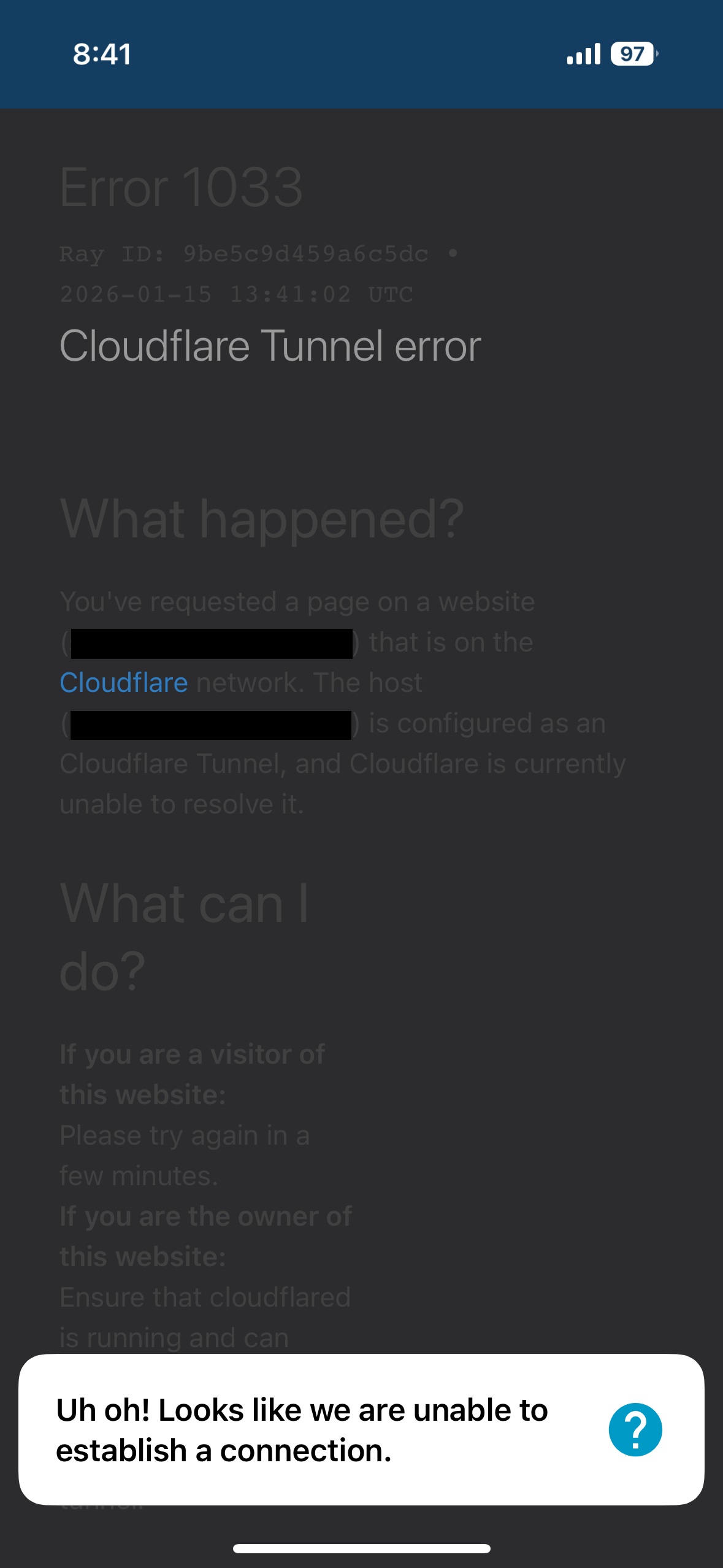

However, after power is restored when my home loses power, my CloudFlare tunnel for external access doesn’t work. I get the below error page. Local connection works fine. The CloudFlare add-on in HA is set to boot on start.
Current solution: after everything is back online for a bit, if I completely power off my Beelink (HA server) and then boot it back up, the CloudTunnel works again.
Thoughts: my Beelink is on the same breaker as my entire networking box (modem, router, switches, etc.). Maybe the issue is because the Beelink boots up far quicker than the networking equipment? Even still, it could be hours/days after power is restored and it still won’t work. Only applying the “Current Solution” fixes it.
I know this is a very rare situation and typically I’m home to quick fix it. However, I was on vacation recently and we lost power at home, so I was not able to access HA for a few days until I returned home which was a bit problematic.
