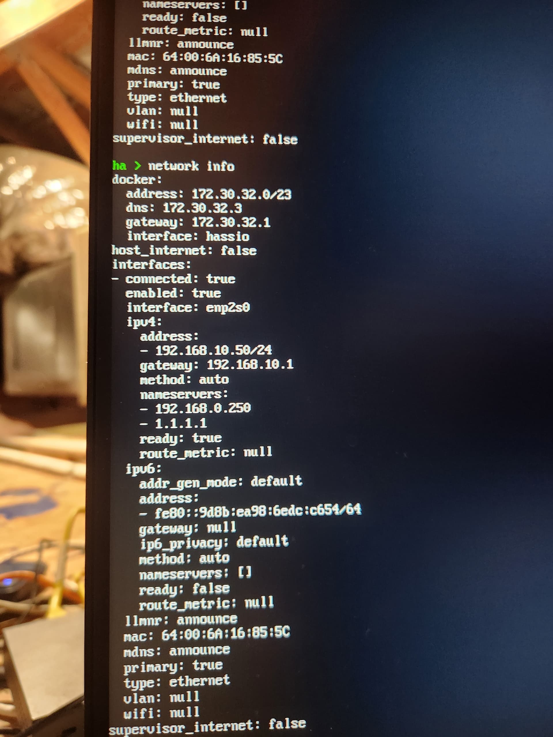

Further more the HA box when connected to the VLAN id:10 port does get a valid 192.168.10.xx ip address. It shows a fully configured network
“ha> network info” command, but the HA box doesn’t respond to pings or connect.

The problem is specifically with HA and VLAN tagging. When I connect HA on the VLAN:id 10 port it is neither pingable nor does https://192.168.10.50:8123 open. When i connect any other normal laptop on that port it is pingable and connects fine
Further more when i connect the HA on VLAN:id 10 the router logs show it is routing the packets to that port, also the pings comeback with no response and not " Destination Host Unreachable" which is what you get when endpoint is not connected/routed.
There is something in HA stack which is actively black-holing VLAN tagged packed.
