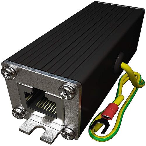

for the future you can alway get one of this
