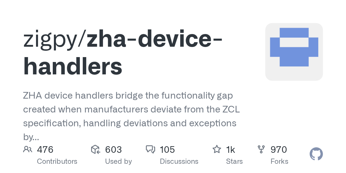

I still just have issues with two controllers that don’t expose their functions, such as the ZG-101ZD which is recognized as in this issue.
I get the documentation about Zigbee2MQTT, but how should I tweak devices now that I use Zigbee Home Automation over the network ?
Is there any documentation anywhere about that ?
nevermind, I’ve found :
