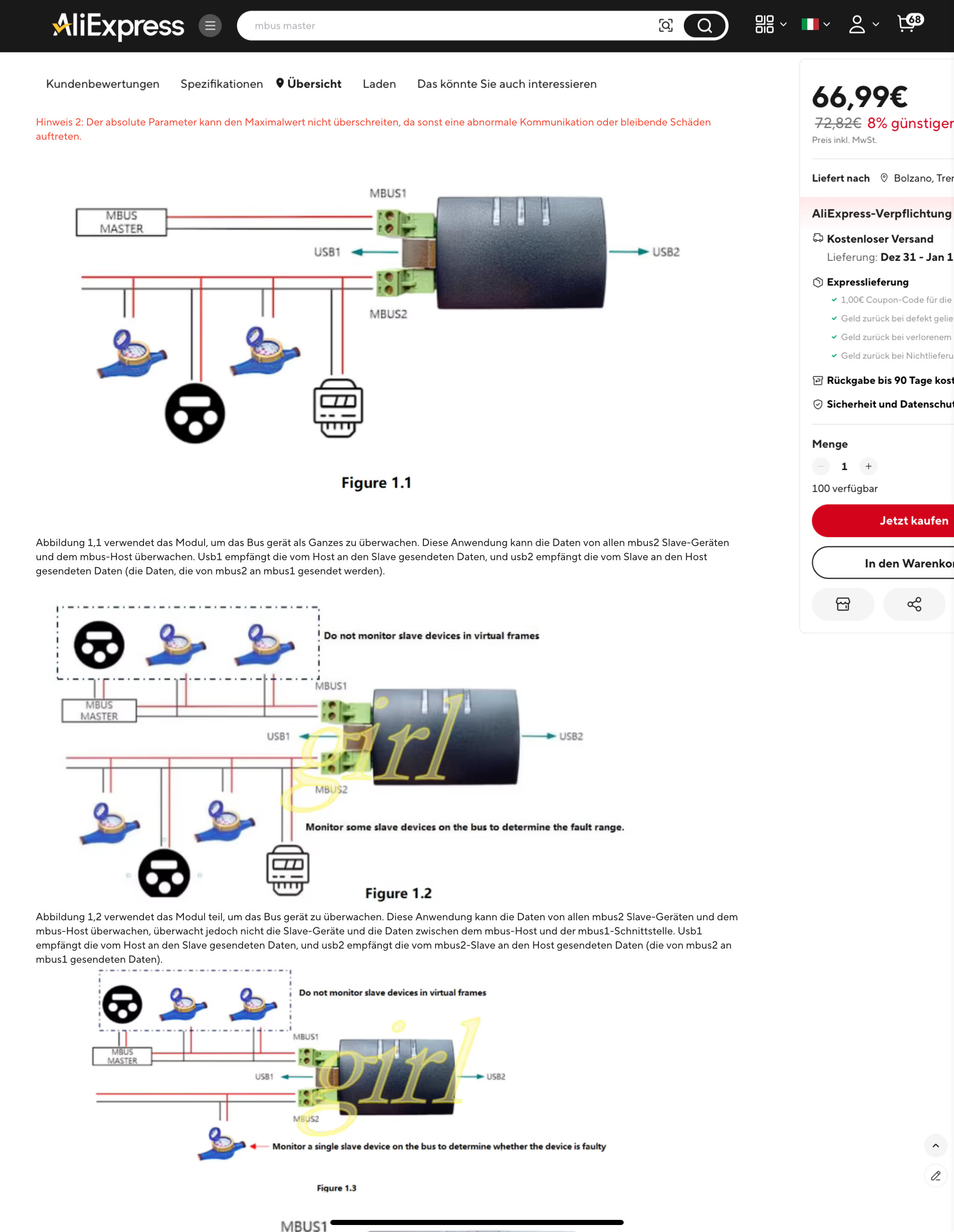

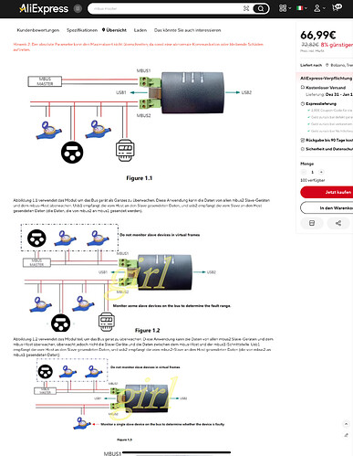

is the USB-M-Bus adapter you use in your blog a master or a slave? I already have a master in the M-Bus network. Is your solution capable to sniff on the M-Bus network? Are there cheap solutions to read the Mbus with an existing master?
THX
Yes, you can use it with
I use a master and as far as I know, there is no sniffer solution out there. It was on my to-do list since months, but I had no time for it yet…
Maybe this thing can be useful to sniff?

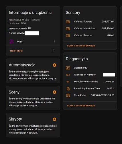

If anybody still search for a wired M-Bus → MQTT Gateway. I’ve already developed one.
It’s an Arduino IDE 2 developed Code for ESPs with a library to communicate Meterbus and one to decode M-Bus.
The HA Autodiscovery Messages will be generate on the fly and you will find the device inside the HA MQTT integration with all records. But you can use every platform if MQTT is supported.
Nearly all meters are supported now.
MBusino → Gateway
MBusinoLib → decoding Lib
MBusCom → the communication Lib…oh I’m a new user and can’t share more as 2 links
If you have questions, ask :stuck_out_tongue_winking_eye:
