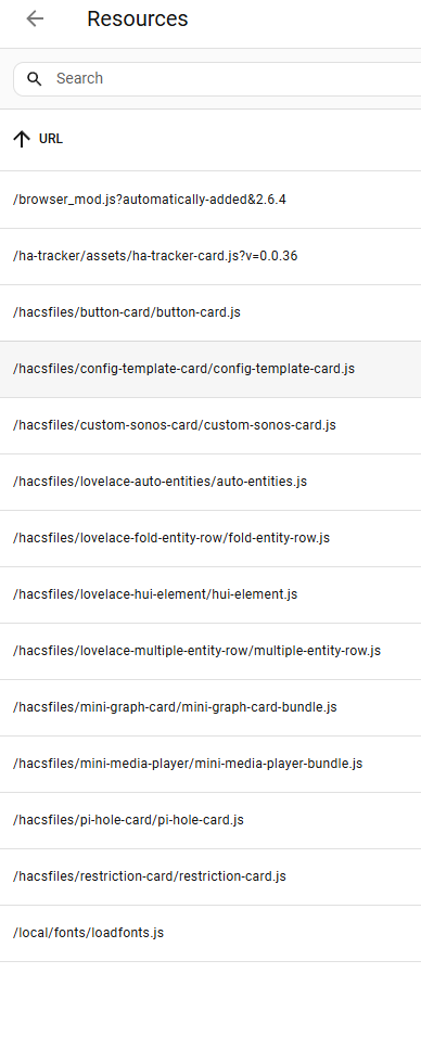

Question 2 is regarding resources.
My dashboard config is all yaml but I have resources defined in the UI as well as in some cases, duplicated manually in my config.

- url: /hacsfiles/button-card/button-card.js
  type: module
- url: /hacsfiles/config-template-card/config-template-card.js
  type: module
- url: /hacsfiles/custom-sonos-card/custom-sonos-card.js
  type: module

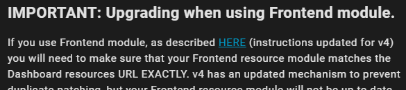

If you have Frontend resource this will load first. As per updated readme, here is some info on why Frontend module would be needed
1. Installing card-mod as a Frontend module via extra_module_url will provide performance improvements to non-CAST devices e.g. enhanced speed in applying card-mod to cards, especially when using card-mod themes. Installing card-mod as a Frontend module is also required if you are using card-mod to style panels of Home Assistant which are not Lovelace dashboards, as Dashboard resources are not loaded for those panels. This includes styling the sidebar in your theme for these panels.
You can have both Dashboard resource and Frontend module at the same as long as the URLs match exactly, in which case the Browser will ignore the Dashboard resource as it is the same URL. This is recommended if you use HACS as it will always update the Dashboard resource on update. Check out the readme on Performance improvements for more information.
Open your Home Assistant instance and show your dashboard resources.
Make sure Dashboard Resource URL and Frontend module URL match. Always restart Home Assistant after updating Frontend module URL. The good news is that once you have done this with v4, and no v3 code remains in cache anywhere, v4 will handle double running code and ignore any duplicate patching. However its best to follow the recommendations on matching URLs.
If you want to verify 100%, you can check sources in Browser developer section and make sure only one card_mod.js listed.
