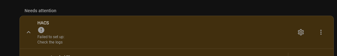

HACS fails to set up after recent update (KeyError: 'full_name')
I didn’t notice this right away, but I’m guessing it popped up after updating HA.
