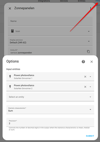

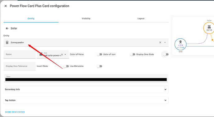

For the Solar did you take the sum or just top one is inverter 1 and bottom one is inverter 2?
If the second option, then the calculation is wrong, as the top one wont be looked at. You need to sum them and set as the bottom entity
Excuse me for the late answer - kids & family & time :wink:
Screenshots are saying a lot more
